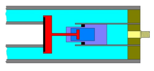

Here's another idea I had but never built, probably the benefits in performance wouldn't be worth the extra complication :
how it works is the purple component of the piston starts to move back but the barrel remains sealed at first by the red component, giving the purple enough time to gain momentum before yanking the red seal open suddenly.
