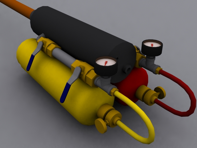

Ok I've just finished the setup I would like to try if I ever get a chance to build this thing.
This should probably be in the Hybrid discussion but here it is. Everything would be held together with wood or plastic spacers and hose clamps. There are some fittings that I didn't take the time to fully model but it looks good to me. I wanted the chamber diameter to be at least 3" so I could use a 1.5" barrel and maybe a 2" as was my original intention.
I haven't decided on an ignition but when I do I will update the design. So what do you guys think, anything need work?
These aren't to exact scale, just what looked good at the time.
Edit*** BTW Jimmy your reply cleared the venting question up for me very nicely.

Are you planning remote detonation?
That's a lot of fuel to have under your chamber
