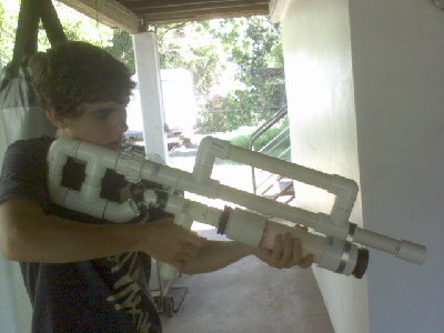

dude thats one sick looking cannon, dead space could have been a problem but i see he used a burst disc which would counteract the dead space.Pyro Ninja wrote:I believe "experiment_u2" made a nice combustion marble gun.
Its called the "famas combustion"
