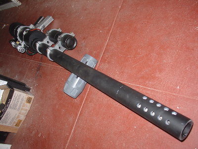

Those muzzle breaks really look awesome. Just really sleek and lethal looking. I know that $35.00 for something that is for looks alone is actually a good deal considering how sweet it is, but at the same time is there any sort of functionality of the device?

Moonbogg wrote:Those muzzle breaks really look awesome. Just really sleek and lethal looking. I know that $35.00 for something that is for looks alone is actually a good deal considering how sweet it is, but at the same time is there any sort of functionality of the device?
These are actually functioning brakes as the 2" ID is the same as the barrel. Earlier in this thread I referred to this not being functional on the BL-417 because of the Barrel ID would be smaller than the brake ID.
I think Tech hit on this before, with a brake you'll lessen the tumble earlier in flight and helping distance and accuracy.

After our weekend of testing we decided to go ahead brake our muzzle to see if the success we we're having with the UHMW rounds through the 520 would follow suit with the BL-417. It did. I am still surprised the difference. In disbelief, I did one last test fire before chucking it in the indexer. Sure enough, the 1st 20 feet curves 3' left, then 10 feet later 6' down... chuck, index and drill 20 - 1/2" muzzle vents at the 60º, 120º, 240º and 300º angles and shoots exactly as the braked 520. UHMW rounds leaves smoothly and from shooter POV has small wag and corkscrew all within a 12" circle.
looking forward to this weekend. cardboard and golf ball net and box of UHMW rounds to see what kind of groups we can get.
