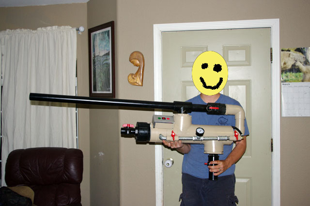

Its been a long time since I have posted on this forum. I recently got my tax return and decided it was time to start building again :twisted: .
I made this advanced compustion with all the bells and whistles I could manage. It has:
-2 spark gaps (powered by bbq ignitor)
-on-board metered propane
-fan with switch and wires nestled neatly in a project box and ball valve for venting.
-break barrel with cam lock quick connect/disconnect
-56" golf ball barrel. I know it should be longer. I had it at 8 foot, but it was too bulky and cumbersome to reload.
Everything is built out of pressure rated PVC. I dont want to hear any lectures about CB ratios, I know all about it. I planned for a much longer barrel but cut it shorter for convenience. I have more powerfull launchers, but as compact as this one.
I have not shot it yet. I plan to take it out this weekened. I promise damage shots and videos.

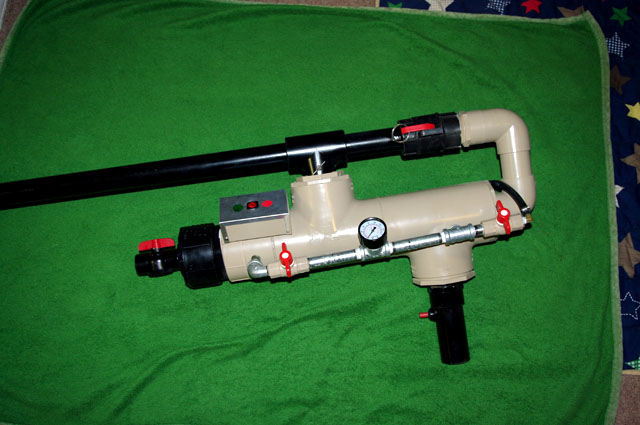

Side view, showing off the details,.
showing the breech open.
Holding it to show scale.
Top view of the cannon.  Yes, I used elmo to prop it up.

Nice to see you're still alive. :) Very nice cannon, too.
The break barrel action needs a little explanation, I think. I looks as if you cut some material out of that tee so that it will bend downward?
Again, nice job!
EDIT: Ah, I see a bolt from that elmo enhanced top view. Nifty.
