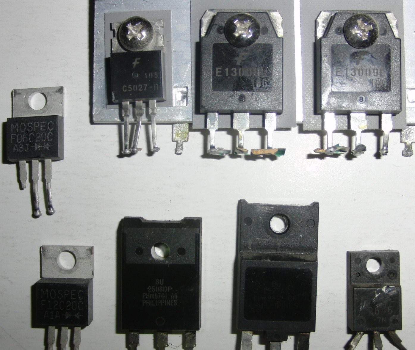

Is this a good time to point out the band on the diode is the Cathode? The output polarity is backward.
As far as the 3 leggged beasts go, the two on the left side are dual diodes.. 2 diodes in a package with the Cathodes tied together.
The C5027 is a Fairchild brand bipolar transistor. You can look up the transistor pinout and specifications by using the full number which is 2SC5027. Do a Google search. From left to right with the leads down, the pinout is Base, Collector, Emitter.
http://pdf1.alldatasheet.com/datasheet- ... C5027.html
The number is part of the Japanese semiconductor numbering system. The 2 is the number of leads -1 so a 2 is a 3 leg device. A 2SA is a high frequency and 2SB is a low frequency PNP bipolar transistor. A 2SC is a high frequency and a 2SD is a low frequency NPN transistor. 2SJ and 2SK are N channel and P channel FET's.
2SA and 2SC devices tend to be RF devices and 2SB and 2SD devices tend to be audio, power supply or switching transistors.
The two lower right ones I can't read the number. The two with the E number, I'm not sure. I'd have to look those up. I think they are either an IC or MOSFET.

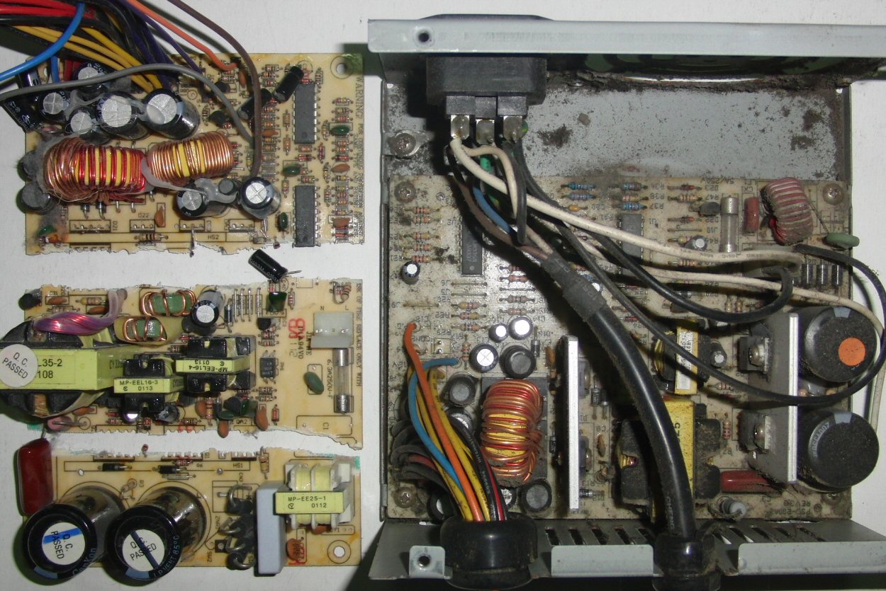

I didn't answer one of your original questions on the computer power supply. The diodes near the AC input are high voltage devices.. May be useful for charging a high voltage flash cap. The Power transistors driving the transformer is a high speed, high voltage, switching transistors. I'm sure you may be able to find a use for that.

I'm trying to put this together with the C5027 transistor:
Top right two: http://html.alldatasheet.com/html-pdf/1 ... TF3-T.html
Middle left: http://html.alldatasheet.com/html-pdf/1 ... 508DF.html
Middle right: http://html.alldatasheet.com/html-pdf/1 ... 527AX.html
And dammed if I can read the bottom right one. Or maybe I can and the markings actually are unhelpful.
