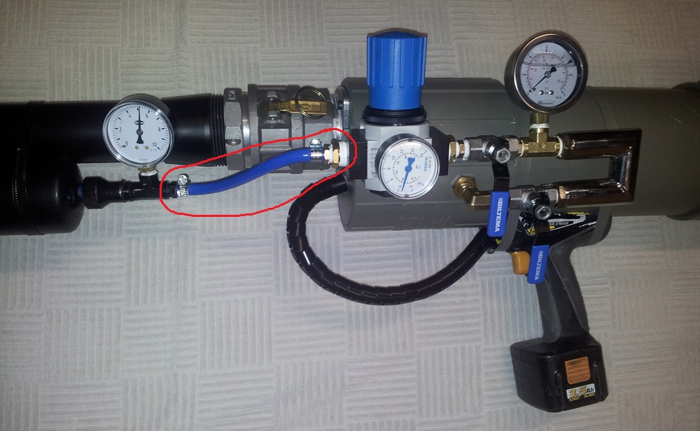

Very nice work, good to see more combustions. But there's one thing I'm not sure about. How do you disconnect the hose when you open the camlock? The picture shows what I mean.

The cannon is not finished yet :-)
On the to do list is a bracket for easy removal of the tank, and a coupling on the hose.
And im gonna use a HANSEN couppling on the hose for easy removal.
One like this, wich is airtight in both ends
edit:
and i also plan to make a quick connect silencer... this baby is loud :-)
