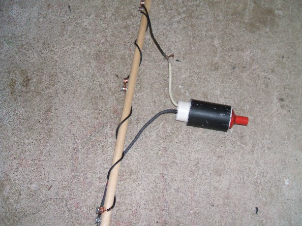

The sparkstrip is done, it just needs to be mounted. It may look ghetto, but it is actually very functional and is much easier to do than etch a copper sheet or put 8 screws in the chamber.

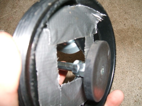

The fan is also done and set up, and just needs to be mounted.

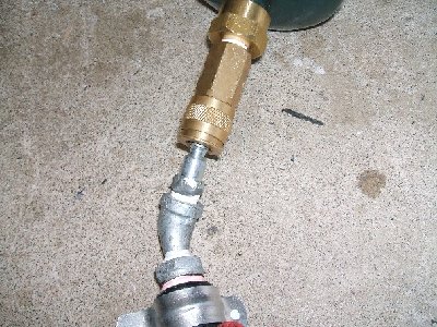

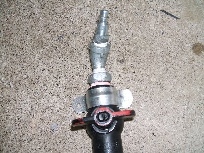

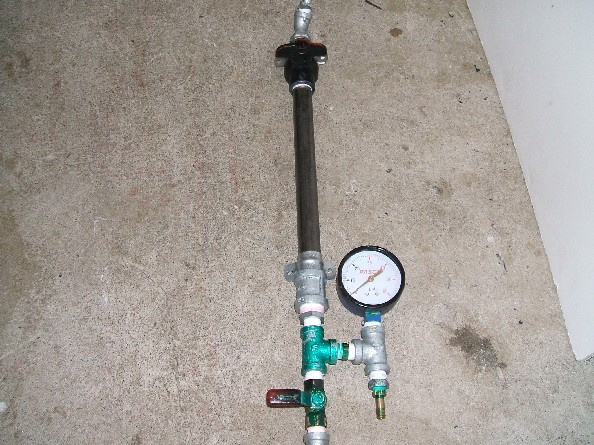

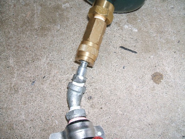

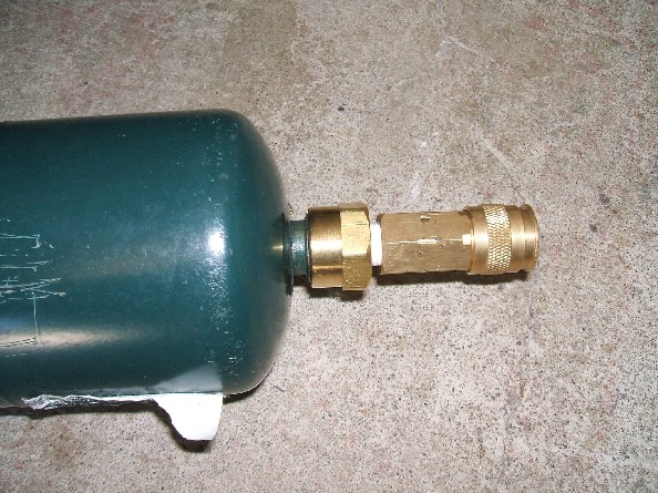

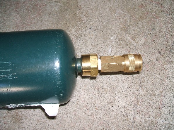

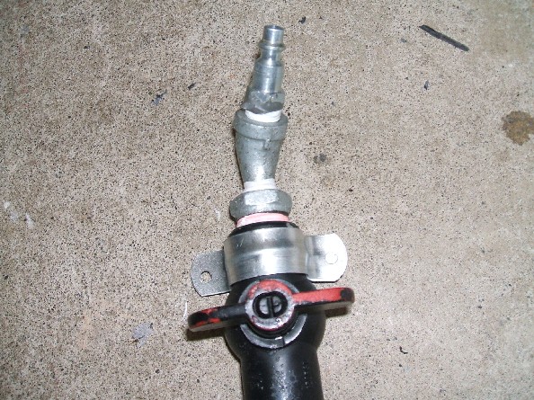

The propane meter is done, and made from 100% spare parts. I didn't even need to get any nipples or anything, I had it all there. And no, the green steel parts will never stop popping up everywhere. Notice the detachable propane filling? Just a propane adapter (super cheap at Ace hardware, only $6!) and a spare female QC.

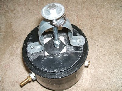

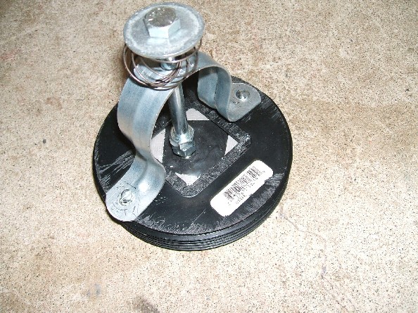

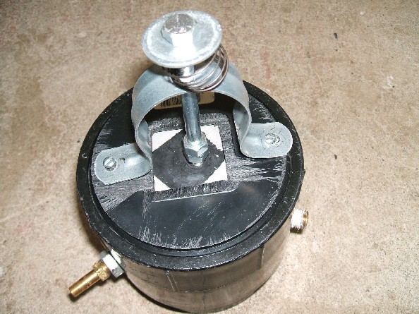

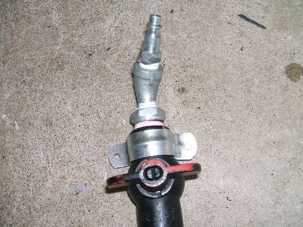

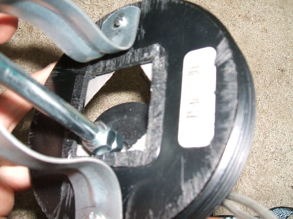

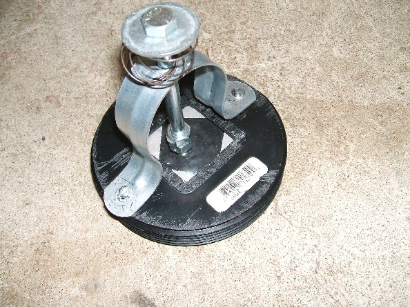

The venting system is the coolest part. Using Gort's idea (which I had also thought of a really frickin' long time ago) and spendin $1.50 seemed quite a bit better than blowing almost $30 on a 2" PVC ball valve. This system is spring loaded, a small modification of Gort's. You press it down, hold it for a few seconds with the fan running, and let go, and it pops into place and seals.

Propane/meter connection.
The whole meter.
The whole meter.
3 spark strip.
3 spark strip.

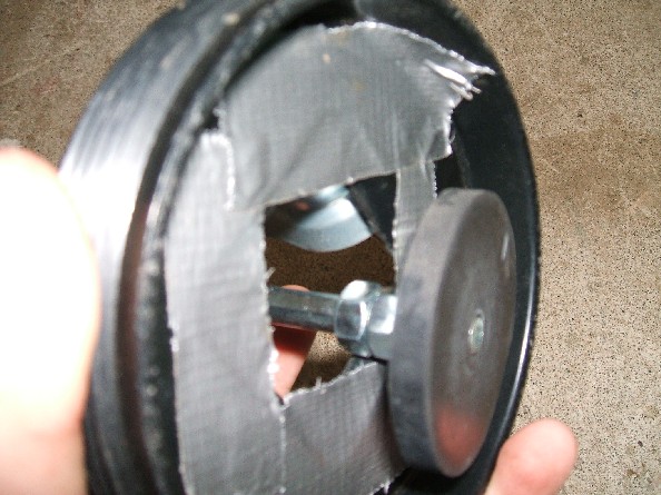

It's kind of beaten up from hacksaw/rasp, and along with the duct tape, it turned out kinda ghetto.
It opens a little over an inch on all sides, which should allow enough air in.
The place where everything happens.

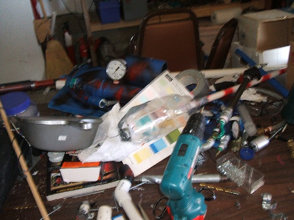

That isn't the actual workbench; that's the table I've moved to because the workbench is so piled up with random crap that I can't see the bench itself. :?
