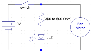

I'm using a 12V fan operating it with a 9V battery and I have a green LED light that I want to install so I can tell when the fan is on. Do I need to have resistors or anything for this or do I have to connect it to another battery? Maybe I have no clue what I'm talking about, I don't know... Is there some kind of diagram showing how to install the LED that I don't know about.

Just connect a 1/4 watt 470 OHM or 560 OHM resistor to the LED. Then you can operate it on 9-12 volts without a problem

So the 560 OHM resistor, the green LED, 9v battery, 12v fan, and the switch can all be in the same circut with no problems?

If you wire the resistor inline before the fan, you will limit the voltage to the fan as well.
Install the LED after the fan, (negative side).

Having the resistor in series with the fan anywhere will slow it down.
Have the resistor and LED in parallel.

I agree with hotwired, have it in parallel. Then you can either wire in a resistor with the LED, or you can get one that has it built in.

This is how to do it
9V battery, switch, resistor, LED and fan circuit

Heh, I don't know what I was thinking. There's no excuse this time, I'm just a dumbass. I will say that I'm not an electrician, though. 8)

jimmy101 wrote:This is how to do it
That's not gonna work, sorry. Electricity takes the shortest path ALWAYS. I'm not an experienced electrician, but I do know that is not going to work. The LED will light up, the fan just won't work.

miskaman wrote:That's not gonna work, sorry. Electricity takes the shortest path ALWAYS. I'm not an experienced electrician, but I do know that is not going to work. The LED will light up, the fan just won't work.
wrong. not much more to be said.

Your right, you're not an experienced electrician. Its called wiring in parallel.
sigh
Yep, you are not only not an experienced electrician but apparently you know little about physics.
Electricity does not take the shortest path. If it did, every 120V outlet in your house would have a big ass arc jumping from the hot plug to the common and/or ground plug. That is the shortest path. Why would the electricity bother running down the wires to an appliance when it can take the "shortest path ALWAYS" and just arc through the air?
Electricity takes the lowest resistance path, which may or may not be the shortest physical path.
If the power supply can supply sufficient power, then all parallel paths will carry current. This is almost always the case in a real world circuit. In my drawing the current through the LED is limited by the resistor. The current through the fan is limited by the internal resistance of the fan. The power supply can supply more than the sum of those two currents.
Every light bulb in your house, along with the fridge, computer, TV … are wired in parallel exactly as in my drawing.
