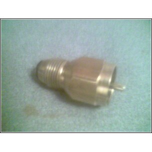

You read that correctly. Never buy a 14 oz propane tank again. Well unless you're in a dire straight and can get to your refill station. Refill, I thought it wasn't possible to refill 14 oz propane tanks. Well not until now. I found this nifty little adapter at Harbor Freight for 16 bucks that allows you to refill 14 oz propane tanks. It's really easy to do but takes about 40 minutes total to do it. You gotta take your tank and throw it in a freezer for about 15 minutes. This drops the temp inside the tank and actually pulls it into a vacuum. Take your adapter that you got and screw it to your 5lb tank first then screw your 14 oz tank to it open the valve on the 5lb and tip the tank upside down. This pulls the propane into the tank as a liquid. You will only get about a half charge before the tank warms up and pressure equalizes so you gotta freeze it again and repeat. After that you got yourself a full tank of propane. Really cool and this thing will pay for itself after about 5 or 6 refills.
Here it is  The 5lb side is left hand thread and will screw inside the OPD valve.
Propane Adapter.jpg (15.67 KiB) Viewed 5056 times

On the old SGTC forums, a member by the name of P_J said that he refilled the tanks when they got down to about 1/4 tank. If you've ever seen these 14 ounce tanks, they are fuckin' THIN. As in probably 0.02" thick. The reason it's illegal to transport them after refilling them is because of the stresses caused by emptying them then refilling them again. The tanks are NOT that durable. But, if they always have a quantity of liquid in them, then the pressure is much more constant. It doesn't matter how much liquid the tank contains, but there must always be some inside it. Otherwise the pressure change caused by refilling is too stressful.

SpudMonster wrote:On the old SGTC forums, a member by the name of P_J said that he refilled the tanks when they got down to about 1/4 tank. If you've ever seen these 14 ounce tanks, they are fuckin' THIN. As in probably 0.02" thick. The reason it's illegal to transport them after refilling them is because of the stresses caused by emptying them then refilling them again. The tanks are NOT that durable. But, if they always have a quantity of liquid in them, then the pressure is much more constant. It doesn't matter how much liquid the tank contains, but there must always be some inside it. Otherwise the pressure change caused by refilling is too stressful.
This might be true, i just dont think there is that big of a stress on the metal, yeah it's cold but those tanks aren't any thinner than refrigerant tanks of that size and it's not illegalt to refill those small tanks, flammable liquid or not
