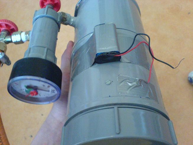

This is my first combustion cannon I built. Nothing really special, just a bunch of advanced ghettoness.
Its about one year old now though it started off as a spray and pray and ended with the following specs:
-Chamber: 110 mm diameter, about 27,5 cm long, 2600cm^3 volume.
-Barrel: 50mm barrel, ID about 43mm, perfect for golfballs. Length: 145cm, 2100cm^3 volume.
C:B ratio: about 1.2
-92mm chamber fan
-Dual spark gap, "multisparking" piezo ignition.
-Butane metering
Stuff about it:
-The metering system is quite crappy, due to the fact I couldnt find propane around, I went with butane, wich has way too low vapor pressures. The pressure from the tank differs all the time, and on top of that I couldnt find any adapter for it and had to go with some sort of crappy pressure relief valve wich further reduces pressure. But after I hammered a long nail into it and covered the hole with solder, it worked. When the pressure is too low, I just inject another shot and it became a "inject, guess and pray".
-The fan system is a 9V battery ducttaped to the chamber and to turn it on I just attach the wires to the bolts wich connect to the fan inside.
-The ignition system is a rare form of piezo sparker. On a small spark gap as it is intended to be, it gives about 10-20 sparks on both pressing and releasing the ingnitor. When enlarging the spark gap it does less sparks.
On the current setup it sparks 2 or 3 times on both the press-in and the out.
Ofcourse I only need one spark so its quite useless but its a weird thing.

Look how well they fit :D
The 92mm fan, blades are a little bit dirty because some earth got into my chamber while playing in the outdoor.

but is it pressure rated ?
it looks like the ordinary pvc.

@ sniper hero
Define pressure rated.
Something thats rated for 30 psi also is pressure rated.
But your right on one hand:
This is not like DWV, but also not really pressure pipe.
I googled up specs and it should be able to hold about 6.2 bar.
Its fine for combustion... I think.
Anyways it didnt explode yet, and Im not planning to do much more shots with this gun.
I built this to get some experience with combustion cannons. I will post some other cannons soon.
Though this is my first combustion, it may also be my last one. Combustions are illigal in the netherlands and pneumatics are not while having more power.
