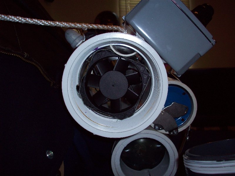

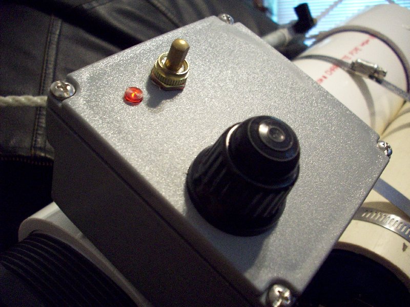

The mixture fan is a standard RadioShack 12VDC fan, wired to run off two 9 volt batteries. I also wired a small red LED in parallel with the fan with a small ??? ohm resistor (forgot already) to signal when the fan was one. Ignition is provided by an electronic grill igniter which I mounted directly into a conduit box without modification, because I am lazy.

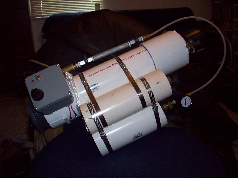

View of the chamber and its attachments...
The control box...
The control box...

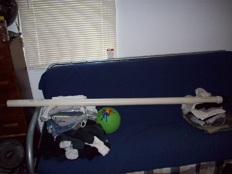

6' golfball barrel...

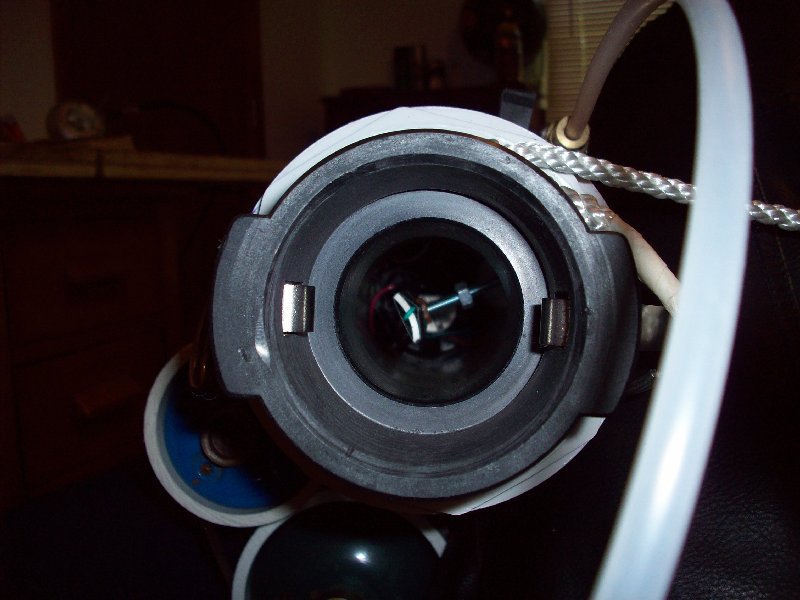

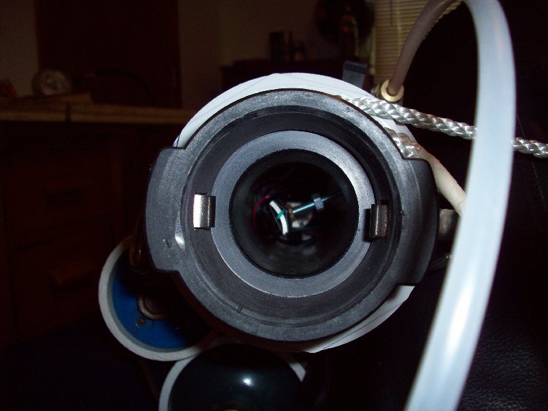

Camlock fitting at breech...

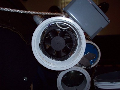

View of the mixture/vent fan...

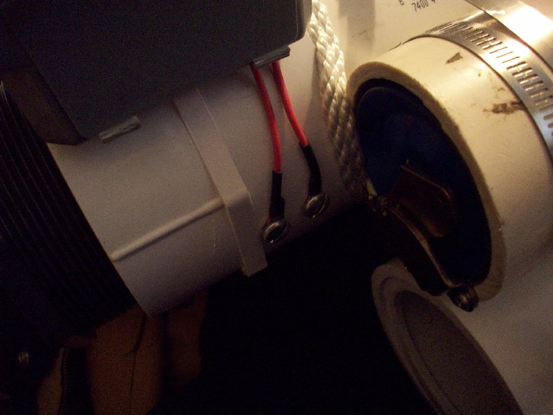

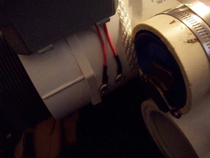

Ignition wires...
Ignition wires...

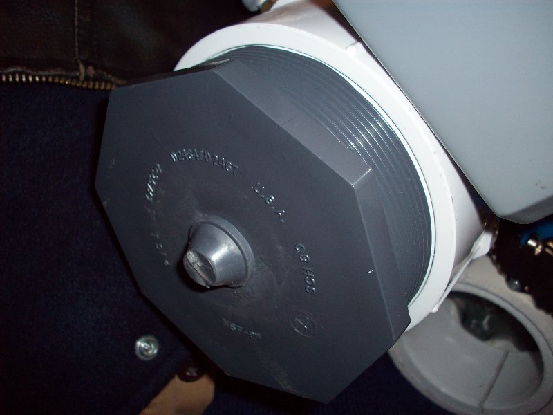

4" SCH-80 plug = piece of mind...
Spark strip...
Spark strip...

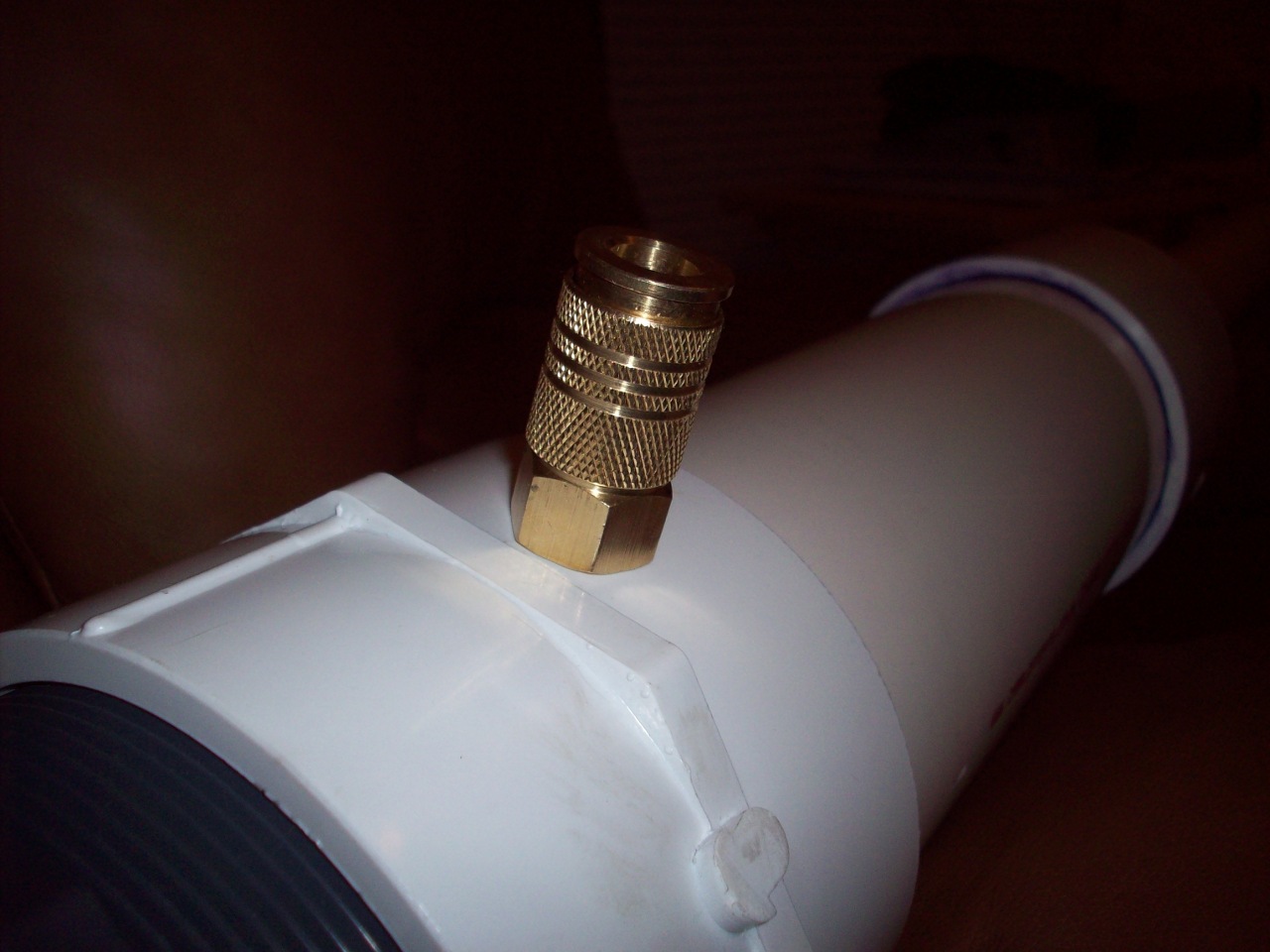

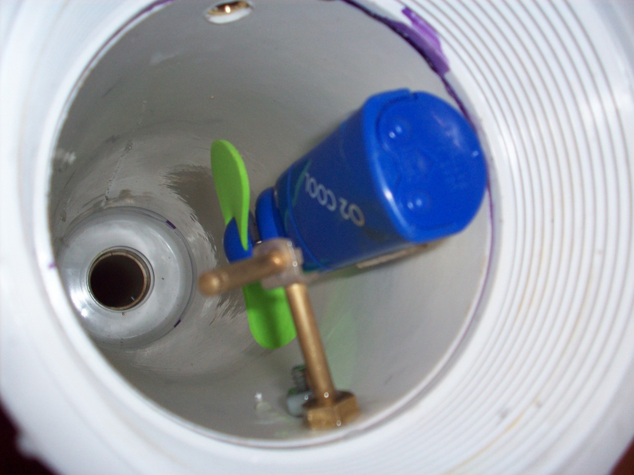

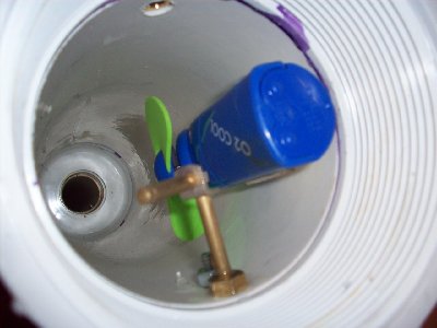

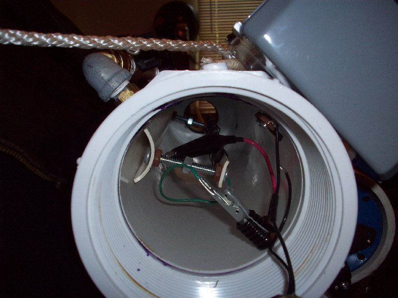

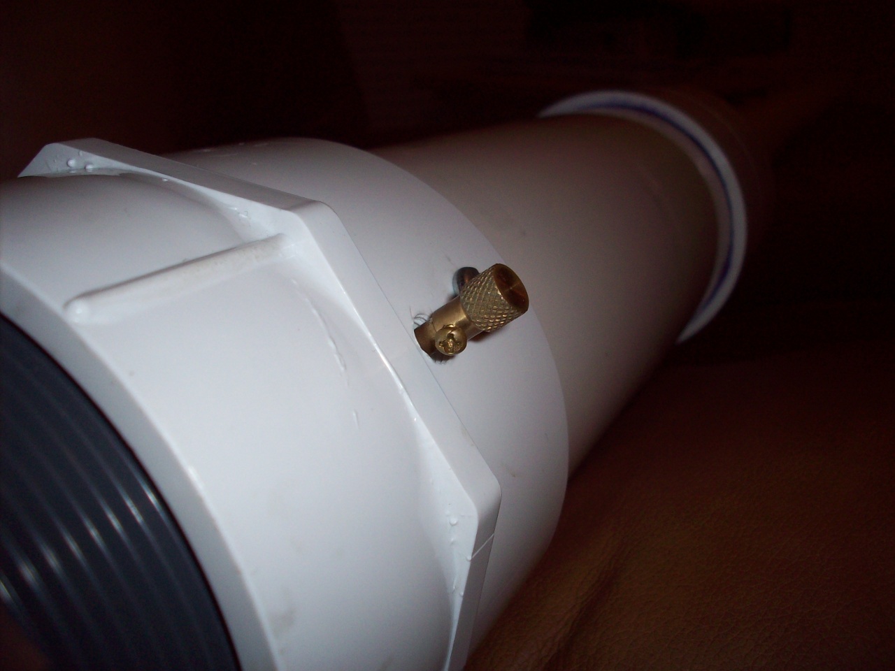

I simply removed the spark strip and PC fan, mounted a cheapo wal-mart keychain fan on two of the 1/4"-20tpi bolts already in place (they don't sell my favorite camping fans anymore), enlarged a hole and threaded/epoxied in the lantern igniter, and that was that. I also removed the meter, added some quick disconnects to make it detachable, and even went so far as to get a "push to connect" female quick disconnect for easier fueling.
Some of you might disagree with the removal of the camlock couplings (*cough*starman*cough*), but take a look at it this way. You can't breech-load golfballs through a 2" cam-lock, and if you muzzle-load there's no real way to make sure the ball doesn't roll down the barrel. So, I threaded a 1/4"-20tpi screw into the back of the barrel. I simply insert the ball, and tighten down the screw to keep it in place.

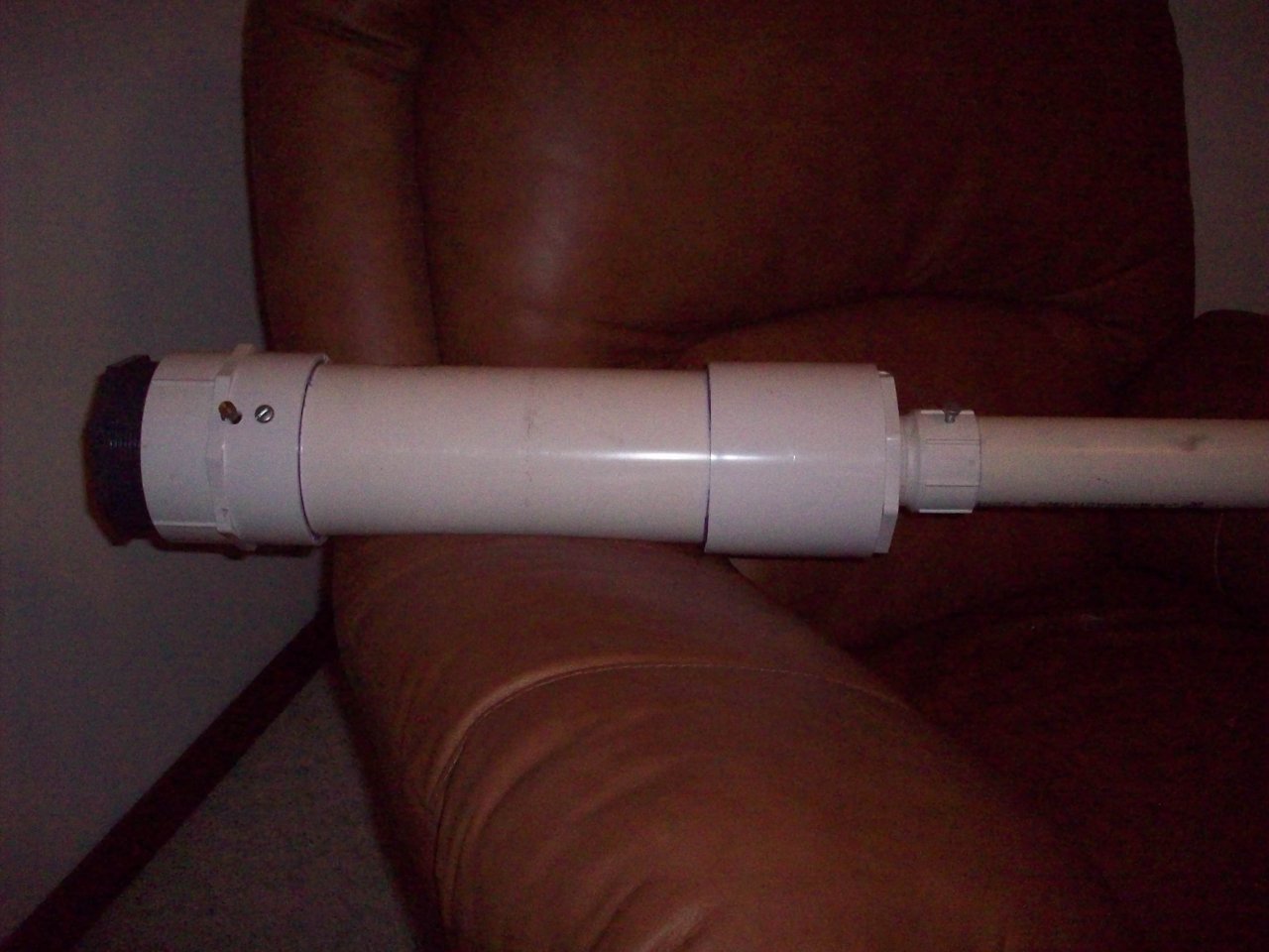

Grainy picture of the entire gun. Overall, it is slimmer and less eye catching, but it will work just the same.
I thought I was so smart. I thought the threads on the lantern sparker were 3/8"-16tpi, and so I enlarged one of the 1/4" holes and tapped it as such. Of course, the lantern sparker fit too loosely, so I just threaded it in all the way and epoxied it in.

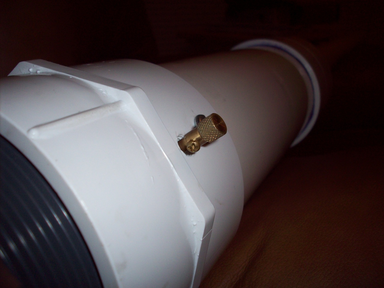

Nothing to see here. Just a quick-disconnect coupling. Simply push the meter onto it and go.
The fan and lantern igniter viewed from inside the chamber. The wal-marts around me stopped selling those yellow camping fans, so I looked around on the "fan aisle" and found this. Should work...
