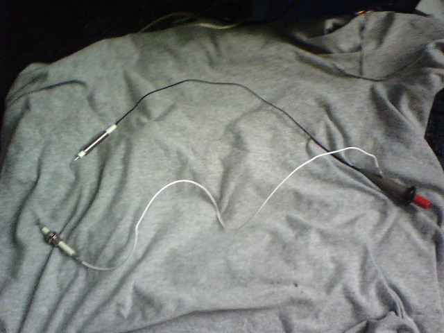

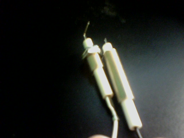

Ok now i need help. I have the BBQ ignitor and it has 2 leads and electrodes on the ends i need to make a box for the ignitor its self how do i do that ? links or pictures would help

yeah but it is set up weird. it has the ignitor housing then 2 wired plug in to the 2metal pieces on the housing one on the bottom and one on the side giving me 2 8 inch wires with steel electrodes on them

sprayandplay08 wrote:Ok now i need help. I have the BBQ ignitor and it has 2 leads and electrodes on the ends i need to make a box for the ignitor its self how do i do that ? links or pictures would help
Slow down a bit, do some more research on this. Figure out your spark gap design (usually screws pointed at each other) and a way to wire it. There are many ways to mount the ignitor...scanning the cannon showcase should give you plenty of ideas.

*DEEP BREATH* ok i know how i want to set the gap inside but i need a
housing for the button. :study: i'll go look around

u can cut the ceramic electrodes off and throw them away and use the screws like starman described, should do fine. welcome aboard.

the shiny part u see at the ends is a threaded shaft with 2 nuts for each one

Just chop off the thingies on the end. Make your own electrodes from screws or bolts. As for the ingitor housing, lots of people put them inside peices of pipe and make handles out of them.

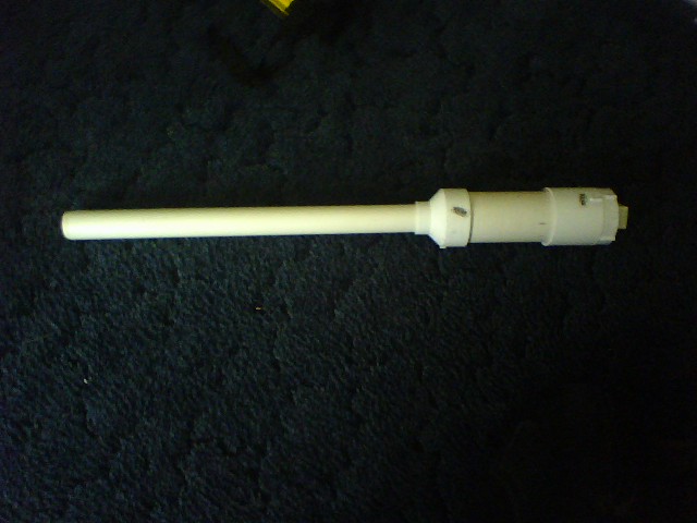

First Dry fit
First Dry fit

*gasp* Bell reducer.
DWV, Non-pressure rated.
Sorry, Back on topic:
Screw in two bolts trough your chamber walls (trough a double layer, where a fitting is on the pipe)
Then cut of those two weird electrodes and connect em to the two bolts.
Bend the bolts a little if nessescairy so they are as close as possible to eachother while not touching eachother. An 1/4" gap or less is preferred.

Chop the metal parts off the end of the wires on your piezo and replace with alligator clips like this;
Some heat shrink tubing makes things look nice and gives you some insulation. This design lets you move the piezo from gun to gun.
Screw a pair of fine thread drywall screws into the chamber so that their tips end up within ~1/8" of each other. The drywall screws work well, the fine thread means you have several threads actually in contact with the pvc, the sharp points make it spark more consistently.
