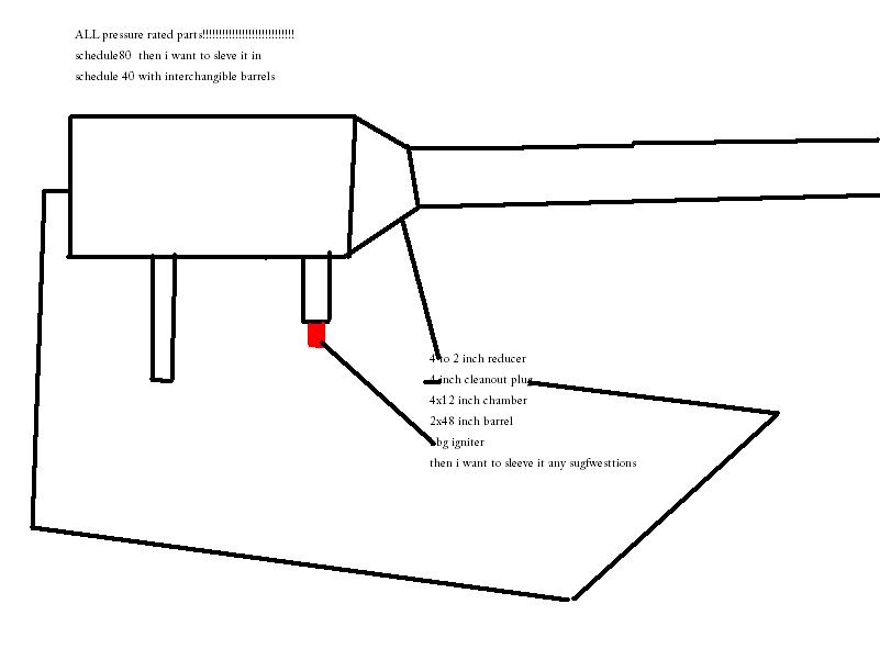

oh and also this is kinda my idea for a new cannon
i want to sleve it to be on the safe side. thank you for your help every body
my next cannon maybe

Tue Aug 05, 2008 4:56 pm
You don't need sch-80
sch-40 will work fine, just make sure its pressure rated
and your only other problem is how you are mounting you igniter.
