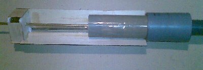

I've decided to revisit this idea, here's what I have so far, looks promising :D
How's that for blowback :D took the ignitor right out of my fingers hehe
That was done with just a loose fiting marker cap as ammunition, there should be plenty of power to cycle a semi-automatic action. now to build the breech, watch this space.

hahah AWESOME JSR!!!!!!!!!
That'll definitely help me out with my project. I just need to get some glue!!!!
Congratulations on a great success.
However you may need to look into a better sealing method, you lost alot of pressure since the cartridge blew out before it even had a chance to fire--hence the massive fireball at the breech
Has thanked: 581 times
Wed Jan 20, 2010 1:21 pm
JDP12 wrote:However you may need to look into a better sealing method, you lost alot of pressure since the cartridge blew out before it even had a chance to fire--hence the massive fireball at the breech
The cartridge is an extremely good fit in the breech, naturally because it's cast around it. I wrapped some packaging tape to allow for a slightly greater cast but we're talking about one thickness of tape, I'm not worried about the seal. Consider that in the case of the above test there was absolutely nothing holding the cartridge or breech other than their own weight, and also the projectile was extremely light and loose fitting (about 0.74") - knew from my previous cartridges that there would be blowback and I didn't want it to be too powerful, this was more of an ignition test.

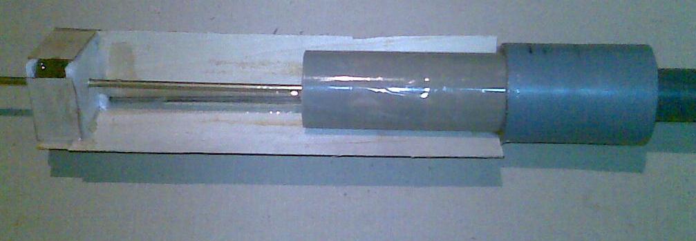

Here's what the action looks like so far, if it looks a bunch of scrap loosely held together by copious amounts of binary adhesive, it's because it is :P
Hope to have it ready for single shot testing by the end of the weekend.

Yep!!! Thats exactly what it looks like. :D
But it looks good nonetheless!!
