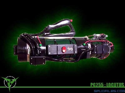

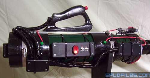

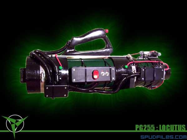

"Locutus" was built soon after "Thug '03". Talk about a project getting WAY out of hand...
"Locutus" is a monster. It took over a week to build after the plans were laid out (a long time for a spud launcher!). It was also the first time I have ever used an electronic high voltage ignition system - salvaged from a stun gun. (It was actually pretty simple) All in all, it was a fun launcher to build, and a fun one to launch :)
The Locutus is currently my crown jewel. It features the following accoutrements:
~255 cubic inch chamber
Dual fire 100,000 volt ignition system
3 step kill switch system
"VisaFire" system (allows safe viewing of ignition jump so you don't have to look in the chamber - my own personal design :) )
Brush less chamber fan with piggyback switch (allows easy use of the fan without having to put down the gun)
Minigun style grips (wood, aluminum and fiberglass) for easy transporting and firing
All ignition system components have been designed to be water resistant
Ignition system has a patch-in location for remote launching
Interchangeable barrels
New design for the barrel cutter (makes it a LOT easier to cut a spud) </LI>
Provided By - <a href="http://www.vochraye.com/spud/">http://w ... /</a></div>
The &amp;quot;Product Shot&amp;quot;
The &quot;Product Shot&quot;

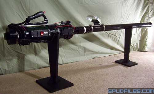

The PG255 &amp;quot;Locutus&amp;quot; with standard barrel attached. (those aren't legs - it is on a stand)
The PG255 &quot;Locutus&quot; with standard barrel attached. (those aren't legs - it is on a stand)

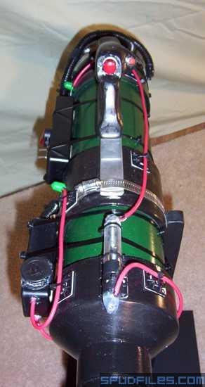

Detail of the chamber showing kill switches. The ignition switch is on the handle. The fan switch is on the opposite side of the handle, so you can't see it in this pic.

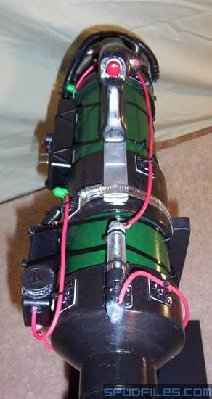

Top view of the chamber. You can see the fan switch on this one. The clear cylinder at the bottom of the picture is the &amp;quot;VisaFire&amp;quot; chamber that allows you to see if you have spark without looking into the chamber.
Top view of the chamber. You can see the fan switch on this one. The clear cylinder at the bottom of the picture is the &quot;VisaFire&quot; chamber that allows you to see if you have spark without looking into the chamber.

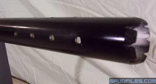

Shot showing barrel cutter.

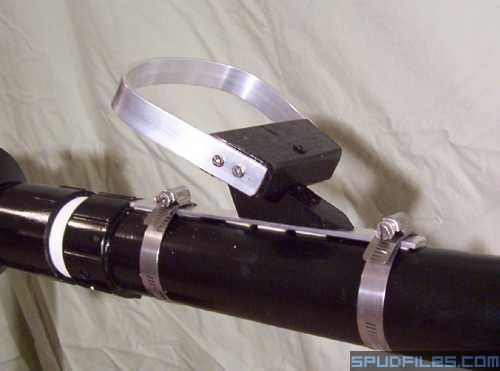

Shot showing front handle.

how does the visa-fire work, does it have a little spark gap to jump, so you can tell if it is jumping?

hmm yea the VisFire thigy sounds like one of those features companys put on that are pretty much useless, no offense :D . I think wut it does is jus let u see a spark jump which tells u if the stun thingy is working but I don't see how it tells u if the spark actually happens in the chamber.

v3ngence wrote:hmm yea the VisFire thigy sounds like one of those features companys put on that are pretty much useless, no offense :D . I think wut it does is jus let u see a spark jump which tells u if the stun thingy is working but I don't see how it tells u if the spark actually happens in the chamber.
I WANT A STUNGUN ignitor, is it legal for a 15 yo to buy one?
In the Visa Fire, the spark will only jump if the circuit is complete. If the spark won't happen in the chamber, then it sure isn't going to happen in the cylinder. Basic properties of electricity people.

yeah, i emailed vochraye and thats pretty much how that system works drac
also the chamber is PVC painted green with a few clear coats on it if anyone was wondering
