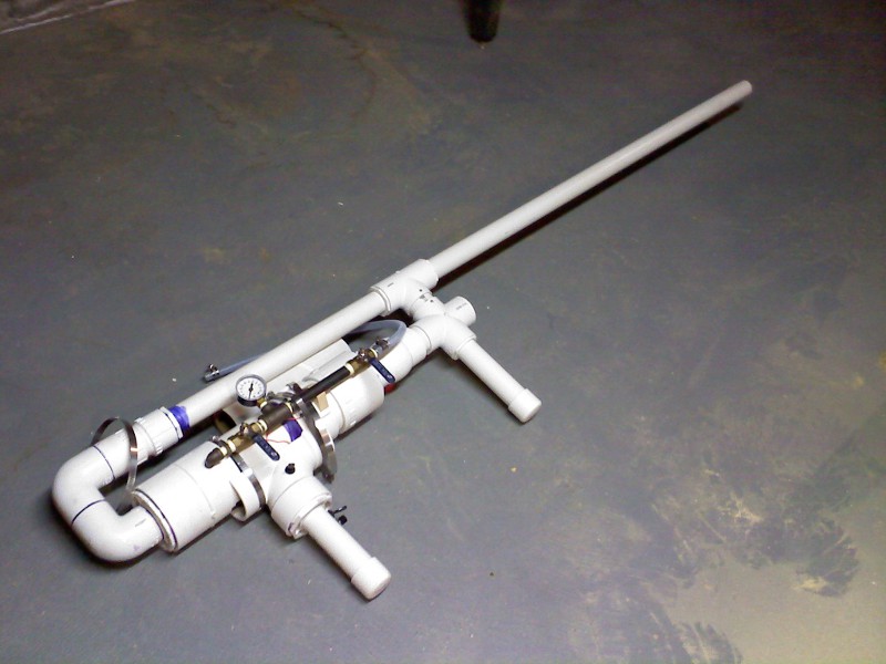

I made this under-over advanced combustion cannon with a friend last summer. It performs very well with an HGDT estimated muzzle velocity of over 500 ft/s with a 70g projectile. It's got quite a kick. The only drawback to the gun is its heaviness. The fuel and metering system strapped on board adds a considerable amount of weight. The gun is triggered by an electric grill igniter housed in the back handle. Sorry I don't have any pictures of the interior of the chamber. I'll upload them as soon as I get a chance.
Stats
  • *Barrel length: 72 in
    *Barrel diameter: 1.5 in
    *Chamber volume: 180 in<sup>3</sup>
    *C:B Ratio: 1.5
    *Fuel: Propane
Features
  • *4-gap spark strip
    *Breach loading barrel
    *On-board fuel meter
    *Push button trigger
    *12v chamber fan controlled by toggle switch
    *Toggle switch safety mechanism
The whole thing (with the propane tank detached -- for now)

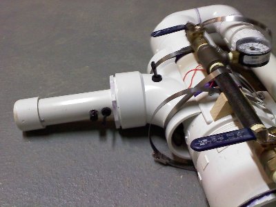

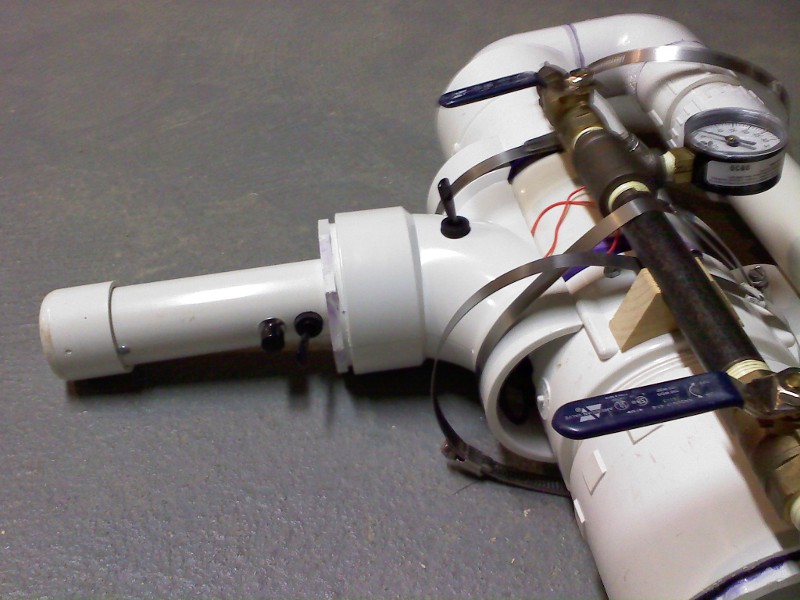

Chamber and trigger assembly

Niiiice. I'm a fan of combustion guns, not that I have a problem with pneumatic's though. You have a good looking gun, and I like the chamber vent through the front grip. As far as the heaviness goes, have you thought about using pvc for the meter pipe? That would lighten things up considerably. Or maybe use a cartridge type propane injection like Starman uses on Triple Thunder.

Look good. It does remind me of one of sb15's launchers. Like he said, I think the front handle is a little awkward... Nice damage though...

Love the gun dude. Looks like good power, good aim, good damage! Needs some paint though! I am always amazed at the amount of destructio a potato cannon can lay out. I am currently in the planning stages of my (which means I want to build but don't have the $$ to build) new advanced combustion. All my cannons have been PVC so they're all kinda heavy; I've learned front handle placement is key. Have you thought about a shoulder strap? Again, awesome effort dude.

The only suggestion I have (which is moot, now) would be to drill your electrodes under the saddle tees to hide the wiring.

With a 6' barrel, I would have just made this thing a shoulder fire cannon. I have one with a 5' barrel and it just looks silly when I fire it like a rifle.
