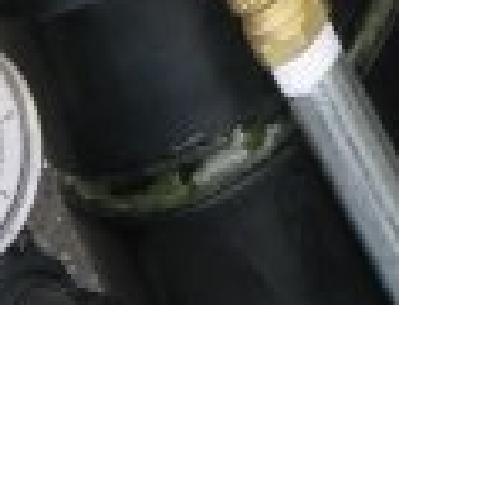

On close examination of the photos of the cannon, it looks like something besides black ABS cement was used for assembly. Please tell me it was glued with the correct glue. :shock: Many glues do not bond well to ABS. ABS cement will solvent weld the stuff.
Is this black ABS glue?

Yes it was properly glued. The black and shiny stuff is abs primer and the yellow one is abs cement
