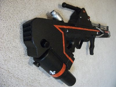

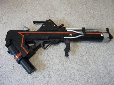

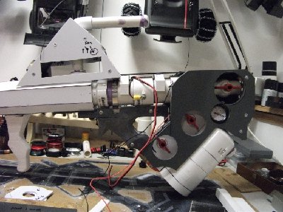

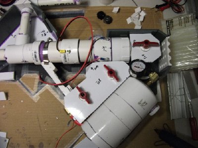

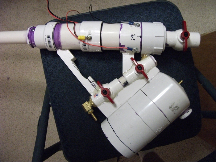

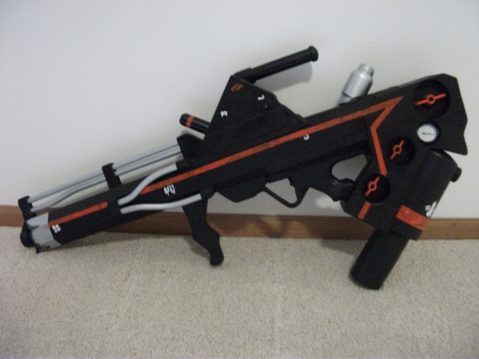

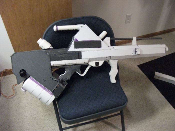

Latest triumph of PVC and sleepless nights. Somewhat replica of the District 9 gas projector gun.
Basics are:
1" barrel
2" x 9" chamber
tazer ignition
internal vent fan
metered propane
muzzle loader
All custom PVC parts

some guts
some guts
before the paint
before the paint
rear view
rear view
Left side view
Left side view

The PVC fabrication took the majority of time. With a few hours of work a week it took about 8 months to finish. Nice work on the airsoft M16.
I'm puzzled by the delay in fire as well, It happens every once in a while. I'm definetly getting spark each time but it took three sparks to ignite in the video. Any ideas?

marcin411 wrote: I'm puzzled by the delay in fire as well, It happens every once in a while. I'm definetly getting spark each time but it took three sparks to ignite in the video. Any ideas?
probably fuel wasn't mixed well or you might have let it sit and the fuel collects at the bottom of the chamber
Wed Jan 11, 2012 1:25 am
I love the way you patted it lovingly when it actually did fire :D
Could your meter calculations have been off?
Crna Legija wrote:probably fuel wasn't mixed well or you might have let it sit and the fuel collects at the bottom of the chamber
If you let it sit, it's even better ;) the gas diffuses and forms a more homogenous mixture.

I usually see two pressure gauges on metered propane combustion cannons. Not sure where yours is connected exactly. Anyone wanna tell me how I can get by with one so I can save on costs?
Sun Oct 21, 2012 4:50 pm
You only need one gauge in the meter and that's it. Don't see the point in having two gauges unless one is on a regulator.

As MrCrawley noted one gauge is enough, I use one on the outlet of the regulator. This gives me a pressure reading and a fixed metered gas volume for setting the proper mix.
marcin411
Posts: 15
Joined: Sun Sep 12, 2010 6:57 pm
Mon Oct 22, 2012 4:32 pm
As an update I was getting a gas leak with the pvc meter pipe and have since switched to steel pipe and brass valves for the metering pipe. Live and learn.
