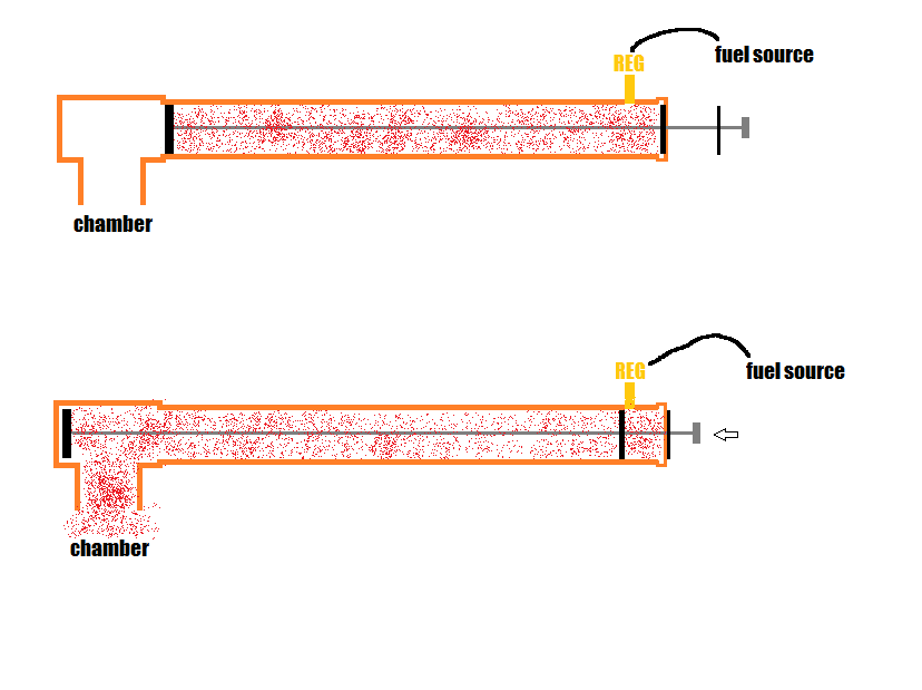

Would this meter work? I'm going for something like the meter from Ultimate Spud Gun

On paper, yes.
In the shop, a bit harder.
The reason I say that is in the shop I have spent countless hours messing with o-ring seals. I have a lathe, and can still be a pain. If you have to use o-rings I suggest using a floating o-ring. Even though frustrating I do enjoy the stubborn route.
If your looking for less of a headache why not go with the traditional metering system? http://img117.imageshack.us/img117/7574 ... ted7gm.png

Even consider a 5/2 way valve foelr one touch metering, like SB did on the TMBA V2. Look in the hybrid section for it.

CS wrote:The reason I say that is in the shop I have spent countless hours messing with o-ring seals. I have a lathe, and can still be a pain.
Not if you know what you are doing, o-rings are built to certain specifications and specific tolerances - and it doesn't take much to do some research and make sure you've got the right seals for the job at hand.
For combustion you only need 3/2 valve, SB used 5/2 valve because hybrid need to be charged with air as well. Now thinking about it, I have 3 of these valves laying around doing nothing :lol: I wish I could get a bottle of propane to build a proper meter for my hybrid :roll:

It would work, but you need to make sure that the valve closes fuel input before it starts to "open" to chamber.. to be accurate it needs to -> fill meter -> close fuel input -> open outlet to chamber.
