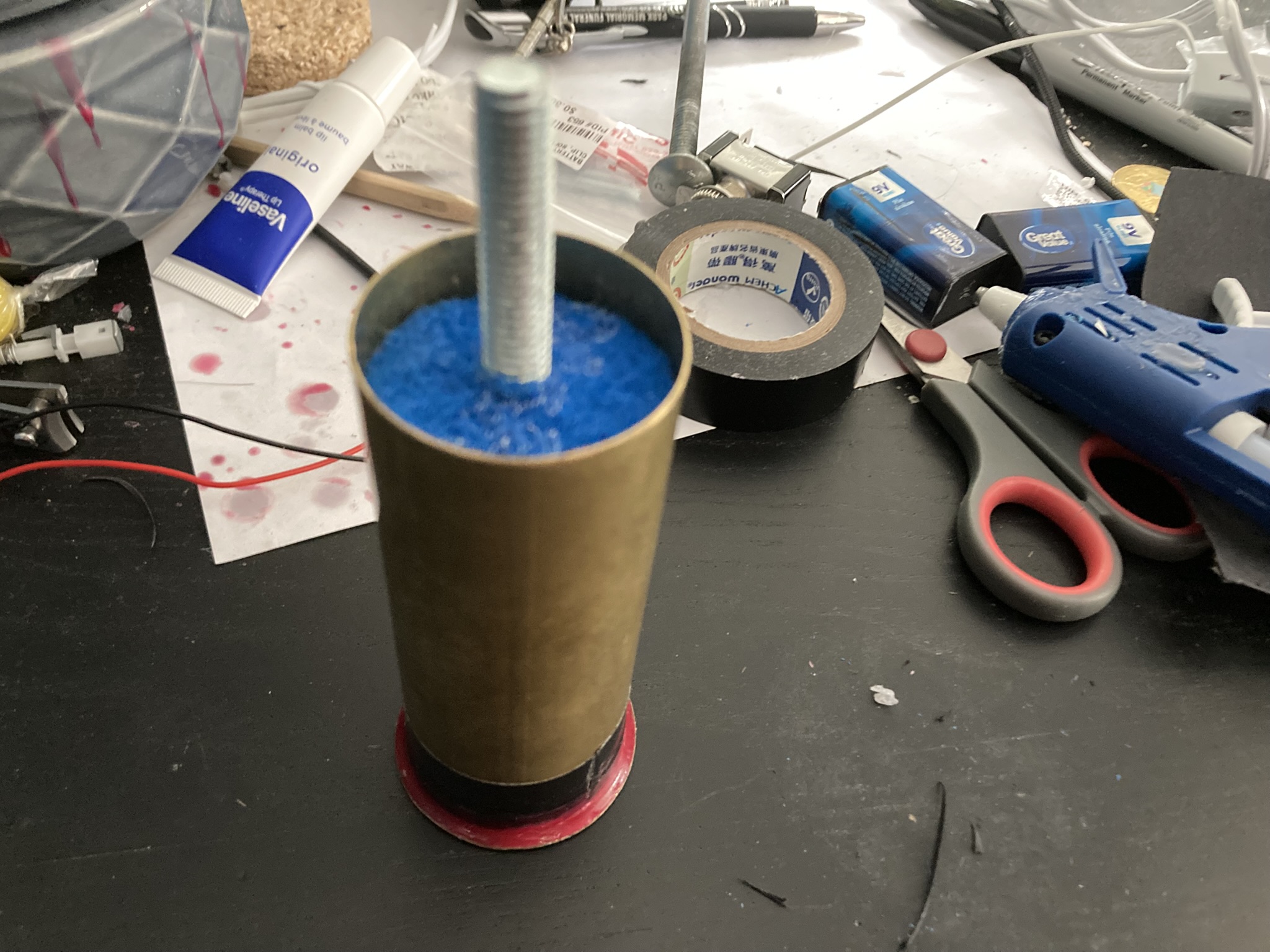

Cannon uses a brass "shell", also known as the 1.5 inch brass fitting I found in the home depot plumbing section, covered the lip area with wax and electrical tape to keep in the pressure so the gas doesn't escape, along with heat shrink on the wires to keep it from fraying, 2 points of ignition for more power, and of course, the "bolt" of it, the floating barrel just simply sitting there with Vaseline applied to keep it's movement smooth, handle and the layering I've added onto it required me to apply heat and bending it to shape, thankfully had a p100 mask my dad gave me beforehand incase of fumes, even when I did it outside

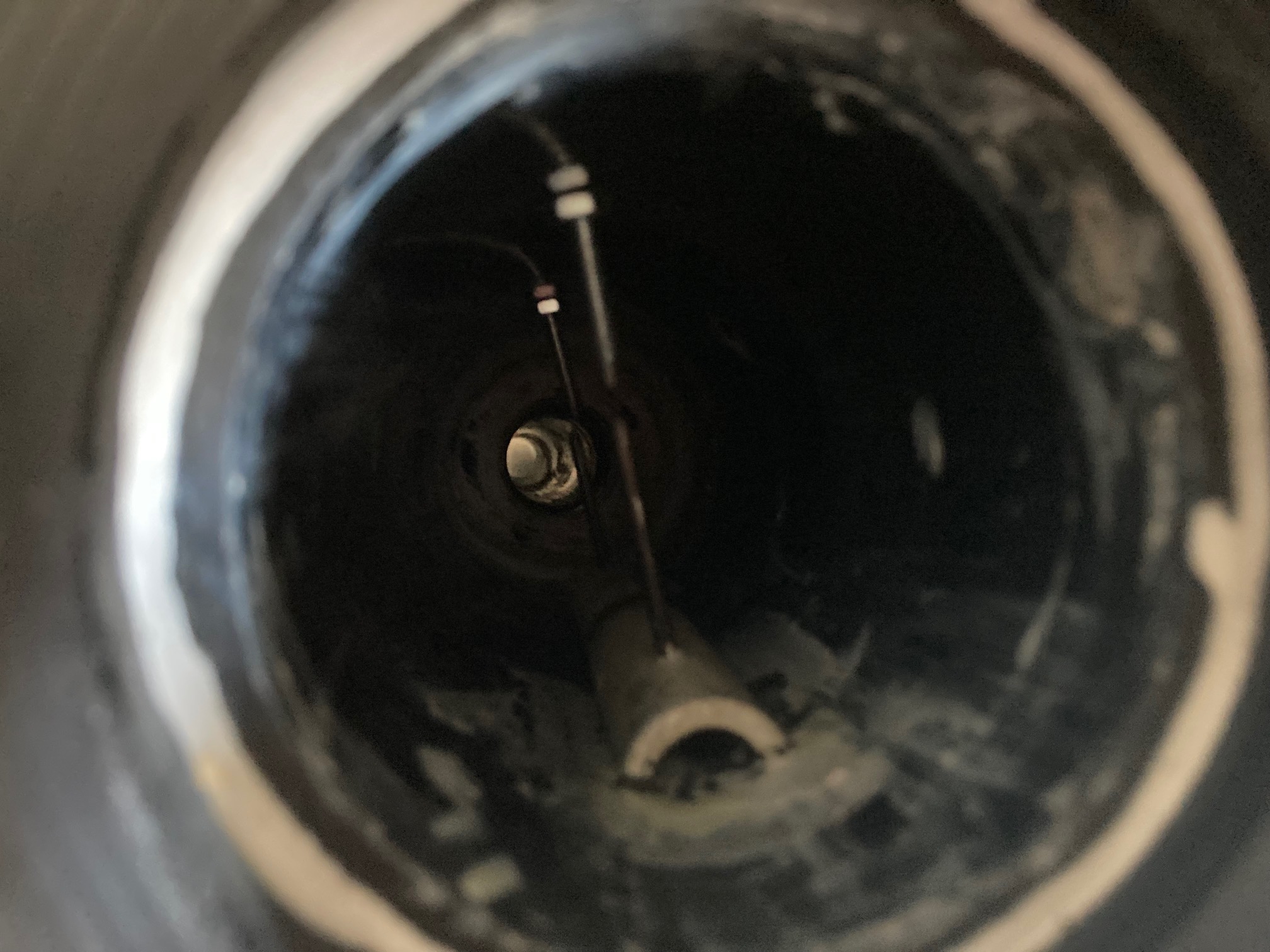

Wires wrapped around 8-32 machine screws
Combustion chamber

Brass shell
