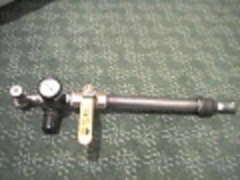

An easy way to attach a propane tank to a metering system is to get a little propane stove and take the end off to fit a pipe nipple to the metering system like I did well a picture is worth a thousand words so this might help if you have any ?'s ask me. Just remember that people hook up there metering ststem's up differentently then mine.
Metering pipe
Metering pipe
Metering pipe.jpg (18.18 KiB) Viewed 2008 times

Do you think that I could buy just that piece or would I need to get an entire stove? Do you have any links to stoves that would work? and do you belive the setup used by HI would work as it seems simple and cheap.

You can find old Coleman double burner stoves for like $1 at garage sales these days. So, I'd say just buy an old propane stove and rip it apart, plus there'll be other cool stuff to mess with. Good Luck Spud
