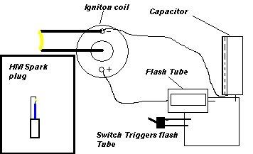

Drew up a quick circuit for you.
And you won't be to use a transformer from a monitor since you have to have a seperate electrical driver to run it.
Edit: Crud, didn't see the other posts.

whats the box in the bottom right? a project box?
And the black+yellow thing is?
lol been so long since i've read a circuit diagram...i might have to break out the manuals

No not a project box, it was just to seperate the simple spark pulg I drew form the rest of the diagram.
And the black thing is wires going from the igniton coil, and the yellow thing is a spark.

He said bottom right, not left. That is a project box. You can put the switch, capacitor, flash tube, and batteries in there. Though I must confess, I don't know what the flash tube is for.

box on the bottom right that contains nothing but just connects the trigger, flash tube, and capacitator-thats the one i mean
does it just signify that they are all connected?
Could you explain what a flash tube is?
Are we talking about a camera flash circuit?
And the spark plug is connected to the - side of the spark gap in that diagram correct? the other one is connected to the conductive chamber right?

Aw sorry Thats supposed to be the circuit bored for the camera flash.
The flash tube is like the switch between the capacitor and the coil, but unlike the switch, it won't weld together after a few uses. So instead of wasting switches, you can use the flash tube as a switch by triggering it to flash like you normally would.
And your right isomer, the one wire of the spark gap is connected to the chamber (which is connected to the middle connector on the ignition coil) and the other is connected to the ignition coil - screw.
