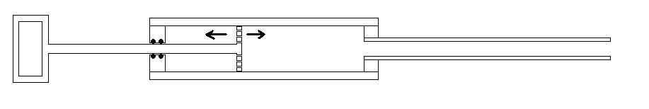

You could use a plunger with a bunch of small holes in it and move it back and forth inside the chamber to force the gases through the same holes to mix it. like this:
attachment gas hybrid mixer.JPG (12.32 KiB) Viewed 1994 times
