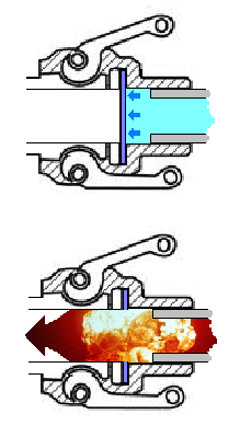

I disagree, depending on how the disk is held. Any force exerted by the barrel "half" of the disk would be held by the cam-lock mechanism itself. This is likely quite appreciable. At the very least you need to compress the disk with u*Fn/(2 sin( burst disk strain cone angle)) to keep it from slipping.jackssmirkingrevenge wrote:One must consider however that the stress is mostly on the burst disk. What the cam-lock has to do is hold the disk in place, it's not really being directly affected by the pressure. Once the disk bursts there should be no stress on the locking mechanism at all.

My point is that the worst thing that can happen is the disk slips and lets out your mix, but it's not going to blow off your barrel on firing.ramses wrote:I disagree, depending on how the disk is held. Any force exerted by the barrel "half" of the disk would be held by the cam-lock mechanism itself. This is likely quite appreciable. At the very least you need to compress the disk with u*Fn/(2 sin( burst disk strain cone angle)) to keep it from slipping.
