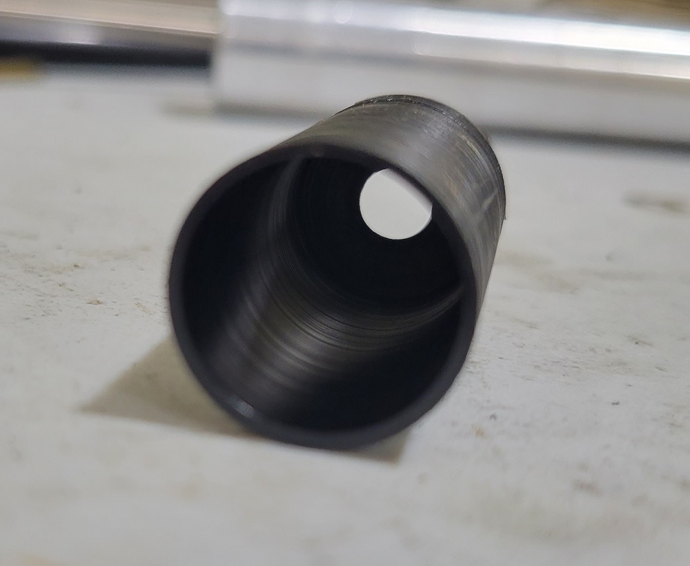

D_Hall wrote: Wed Dec 06, 2023 8:28 pmYou need something to induce turbulence!
Some experimentation was definitely in order, so I machined a Delrin cup to fit the chamber with a 1/4" orifice through the base:
I fired a series of shots and the results were quite interesting.
The first thing I did was repeat the tests done in the first post, at 16x with 0.25g airsoft BBs and with photo paper burst disks.
1 layer - 1903 fps (up from 1525 fps without baffle)
2 layer - 2012 fps (virtually no change from 2010 fps without baffle)
3 layer - no burst (1808 fps without baffle)
I then upped the mix to 20x, with a single aluminum disk it failed to burst, whereas normally even two layers would burst without the baffle.
With 2 layers of photo paper I got 2075 fps with the baffle and 1400 fps without it.
In the latter case the muzzle energy with the baffle is 50 J up from 23 J without it, just over double, with all other conditions being equal. That being said, just looking at these preliminary results, what the baffle seems to do is make up for performance loss from a disk that bursts too early rather than increase the energy up from the optimum disk burst pressure.
That's enough experimentation for this session but I would also like to try cutting down the baffle to make the "second chamber" smaller to see if that makes a difference, I wonder if it will increase or reduce peak pressure at the disk.

Interesting results. According to the scientific article on this topic, the diameter of the hole can vary the results. As I remember, the second division of the camera was much smaller than the first. Good job Jack!!

jackssmirkingrevenge wrote: Thu Dec 07, 2023 12:48 am That's enough experimentation for this session but I would also like to try cutting down the baffle to make the "second chamber" smaller to see if that makes a difference, I wonder if it will increase or reduce peak pressure at the disk.
If my gut is right, making the baffle shorter (increasing volume of the chamber that has the spark gap in it), will decrease performance (decrease the step function effect).

D_Hall wrote: Fri Dec 08, 2023 12:31 amIf my gut is right, making the baffle shorter (increasing volume of the chamber that has the spark gap in it), will decrease performance (decrease the step function effect).
According to the study that inspired hectmarr's other thread, peak pressure should increase, but for a smaller effective volume.

Back to the subject of this thread, for the sake of completeness here are the results of further experimentation posted in the dual chamber thread, I made a second baffle that was both shorter and with a 1/8" orifice that looks something like this to scale:
I then did some more testing again at 16x and using photo paper disks and 0.25g airsoft BBs as projectiles, this time I tested with and without baffle in the same session for a better comparison:
1) 1 disk no baffle - 1136 fps / 21 J
2) 1 disk baffle - 1851 fps / 40 J
3) 2 disk no baffle - 2071 fps / 50 J
4) 2 disk baffle - 2133 fps / 53 J
The results are similar to the previous tests. If the burst pressure is low for a given mixture, then the energy gets a very significant boost from a divided chamber, virtually double the muzzle energy in this case.
This is still lower than a single chamber with double the disk layer. Using one disk and a baffle generated just 75% of the muzzle energy achieved with two disks and no baffle.
It's worth noting that the baffle is not fixed in place and is just a tight fit, so I don't know if it's being moved around during the combustion cycle, it could be that what we are witnessing is not "pressure piling" but simply the effect of turbulence.
My conclusion based on this limited data would be that this setup might be useful with a simple combustion that wouldn't normally use a burst disk, but for hybrids there does not seem to be an advantage compared to using the optimal disk burst pressure.
