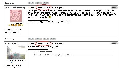

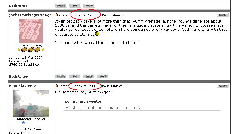

On an unrelated note, how did this happen?
Edit: OOOH... now I see.. for whatever reason I read the first time as 14:47, not 14:17, so it looked like jack posted 1minute after SB15. I think I need to set my text size up :)

OMG you have broked teh universe!!!11exclamationpoint!1!

iPaintball
Posts: 695
Joined: Sun Mar 04, 2007 8:37 pm
Sun Sep 16, 2007 3:27 pm
He just posted later...

Pete Zaria
Posts: 954
Location: Near Seattle, WA
Sun Sep 16, 2007 3:30 pm
@_Fnord,
Thank you VERY much for your contribution here! This is awesome data, and I think I can safely speak on behalf of the whole board when I say "GREAT JOB, THANK YOU VERY MUCH!".
If you get a chance to run a few tests again with a peak pressure gauge setup, that'd be awesome.
I think the time thing is just because you have your preferences set to display military (24-hour) time...
Peace,
Pete Zaria.
Fnord
Posts: 2239
Location: Pripyat
Sun Sep 16, 2007 3:31 pm
Then why wouldn't his post be down below? Am I missing something?
