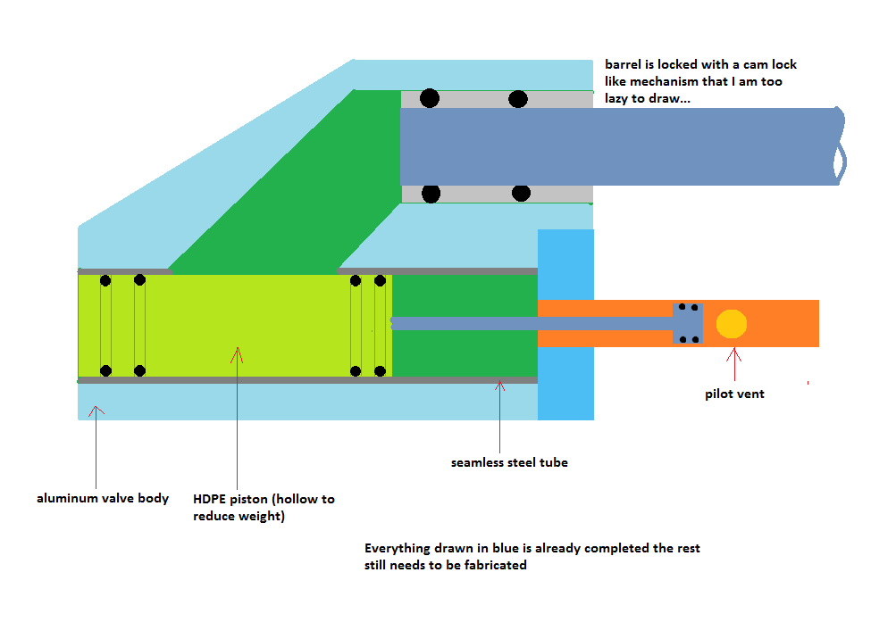

a small update: I have decided on a piston valve design and I have started construction I will attach a pic of the concept of the valve at the end.
Here is a pic of the rough valve body
that is all you guy are getting from me tonight :D :D
here is the concept drawing of the piston valve bear in mind that it is not drawn to scale and a lot of details may be omitted from the drawing..

Your pressure vessel looks to be thick enough to withstand 25x easily, if that is steel I'm looking at. Check it for cracks with a good magnifying lens.
Mon Aug 30, 2010 9:15 pm
If the piston has equal pressure (multi X bar pressure) on both sides before firing, that will be fine by itself. The issue I see is the pilot vent will be unbalanced and may open the piston under pressure before firing.
A slight modification can make the pilot vent balanced too. Put the pilot vent port between the o rings and balance the pressure on the pilot vent. When fired, the main valve and pilot vent opens. Before firing, the piston and pilot vent are balanced.

Technician1002 wrote:If the piston has equal pressure (multi X bar pressure) on both sides before firing, that will be fine by itself. The issue I see is the pilot vent will be unbalanced and may open the piston under pressure before firing.
the way I planned it, it would have been an isolated pilot to allow me to control the opening pressure by controlling the pilot pressure.
to put the vent hole between the o rings to make it balanced sounds good to me, I will most likely incorporate this into the design. thanks for the advice
SpudBlaster15 wrote:While this valve will work, the design is very poor, to put it bluntly.
Your piston area ratio is actually lower than 1:1, which means that without 300PSI+ in the pilot chamber, your valve opening pressure will be far less than optimal for even low to moderate mixes.
I'm also very concerned with the cast aluminum valve body. Aluminum castings (Especially those done using a backyard foundry) are very prone to defects, namely trapped gas bubbles, and without proper heat treatment, aren't very strong to begin with. Which alloy did you use, and do you have any plans to artificially age harden it?
like I said I was planning this to be an isolated pilot design.
Yes Aluminum castings (Especially those done using a backyard foundry) are very prone to defects, but that is only because most backyard foundry men don't follow good foundry practice (and I do follow good foundry practice) 1 they don't control their furnace atmosphere and 2 they don't flux nor degas and to show you that this casting don't have absorbed hydrogen(the gas that causes gas bubbles in castings) I took a part of the gating system from this casting that you would most likely find bubbles if you got any absorbed gas, and I cut a section of it and polished it to some degree to show lack of bubbles
as you can see there is no gas in this blind riser meaning it is nice and solid metal. the alloy used, I cannot remember the name of this alloy, but I can tell you that is a alloy that is a bit more malleable than most cast alloys. I am still looking into the artificial age hardening, still looking for a local place to get it done.
besides the most critical parts of this valve is going to be sleeved in seamless hydraulic tubing (shown on concept drawing)

I also just got to add that the cast valve body is 16mm thick at the thinnest point
If you guys still feels that a cast valve body is unsafe or a bad idea, I'll skip the cast valve body and make this a burst disc cannon

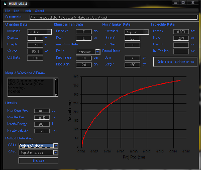

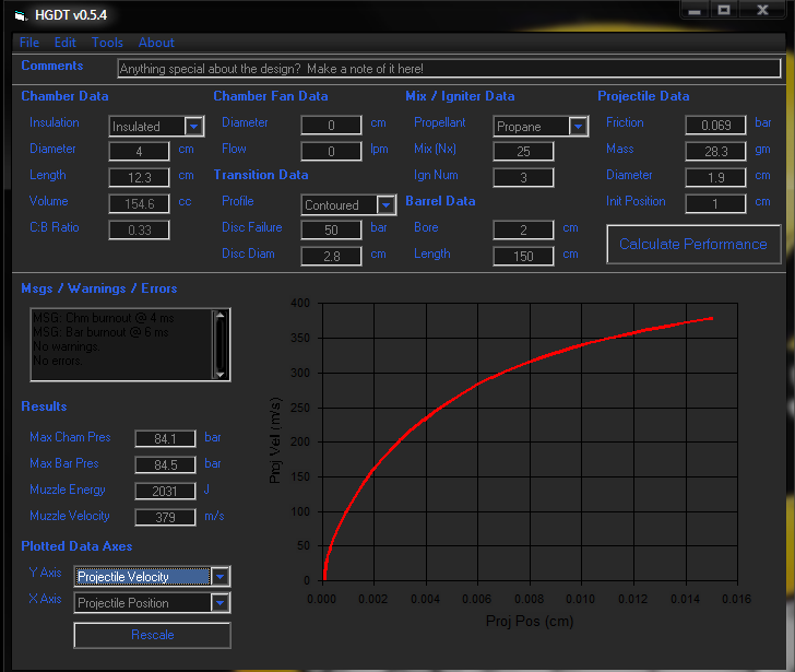

kenbo0422 wrote:Even with no hardening, the thickness of your aluminum should be plenty. Max pressure under firing conditions shouldn't exceed about 500 psi and aluminum doesn't fail like PVC.
the trouble is that I don't plan on firing this under 25X, only 25X and up to a max of 50X and HGDT gives me a prediction of 84 bar for a max chamber pressure (1 218 psi) so perhaps it would be a safer idea for me to first make a burst disc cannon out of this chamber and skip the cast aluminum on this for a while you guys made me doubt my aluminum casting :?

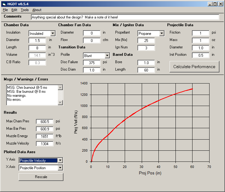

kenbo0422
Posts: 201
Joined: Mon Oct 06, 2008 7:33 am
Location: East Tennessee
Tue Aug 31, 2010 10:20 am
Touche.
Here is my version, using the same program (my mistake, 600 psi).
HGDT info in mostly the same configuration, just a larger barrel and chamber opens right about the 25x pressure.
