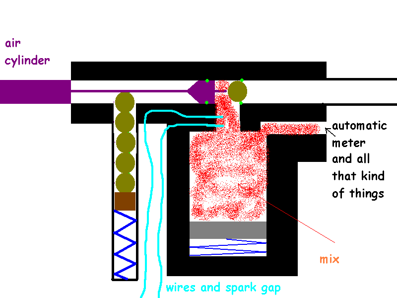

I understand QDVs but i need an explanation on this one.

combine the main valve with the loading mech. (i.e. use a detent)
ohh btw where is jsr ? Is he in russia?/russian girl ?
yeagh I know there is an air cylinder here but it should work with just a sping loaded bolt and/or bolt action

That automated hybrid has been around for such a long time (probably not, but it was one of the first things I saw on Spudfiles), I'm surprised nobody has built one. Probably something to do with the "automated meter and all that kind of things."
Our sponsors had (or have?) a gun with a 3way ball valve as meter... you probably know how it works right ?
anyway if it works with a ball valve you can adapt a poppet/spool valve to do the same job...
then just build a system that first actuates the valve injecting propane, then air and finally ignites the mix
sure it is a bit more complicated than a basic spray and pray combustion but I've seen dozens of more complicated projects on SF
