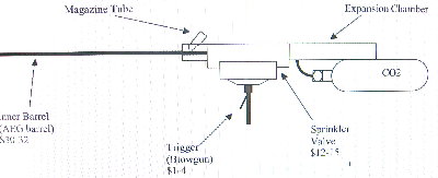

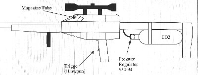

Looks good, except maybe a 3/4" solenoid valve is slightly overkill for airsoft, you might want to look into smaller valves used in washing machines and dishwashers.
You could even use the blowgun directly, power wouldn't be a problem though the fact that you have to "snatch" the trigger would affect accuracy.
