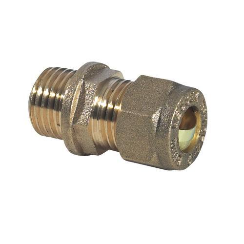

But I love your gun design and I joined this site hoping someone can help as I am building my own based on your design.
My main problem is the barrel. How is the barrel attached to the blowgun?
Also, just by looking at it, I have guessed the other items I need. I just need confirmation and info on anything I may have missed or gotten wrong.
I think they are..
sodastream bottle
sodastream co2 adapter??
Regulator (not 100% sure on what one to get)
Air line
Blowgun
Barrel
Scope
Clamps around the barrel and bottle
Any help will be greatly appreciated.
Also, if people have some upgrade ideas, I'd love to hear them.
I will spare no expense on building one of these beauties :-D
finland66
Posts: 54
Joined: Fri Jan 04, 2013 1:30 pm
Location: Finland
Fri Apr 05, 2013 12:57 pm
hi
mayby this cind coupling
1/4 to blowgun and 8mm OD barrel
