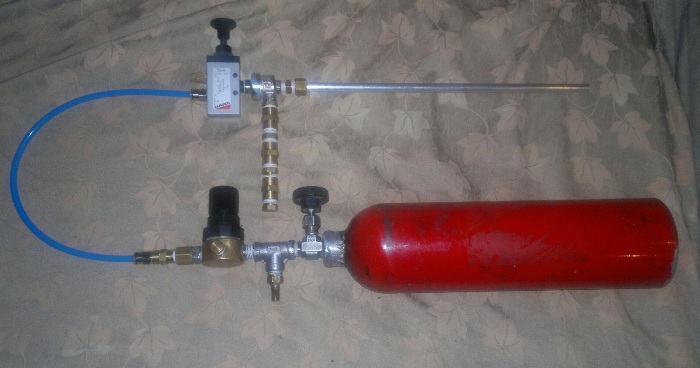

This is the project so far. The "barrel" is attached just for testing purpouses and it's still lacking stock, real barrel, and the trigger which will be instead the 3/2 DCV button.

I like the second design, where the bolt goes through the mag first and then loads the ammo into the Tee where the air comes in.
I've used that before and it works well.
You need just one O-ring to seal the bolt.
I'm not a fan of hollow bolts.
They restrict the airflow and require O-rings in two places to be sealed.

Yes, I believe that the second one is better but I am clueless about how to make either, so any idea on how to make the very bolt? I mean a bolt about 0.18" or 0.23" diameter with an even smaller pin that pushes the pellet further does not sound easy to make, just saying :/
But the coolest part of the second one is that easely once made it can be modified to become part of the air chamber and work as an air cylinder (spring return or air spring return) and make the gun be real semi-auto.
if you go with the .18'' barrel like I did, super glue an o-ring to the top of the barrel where the I.D of the o-ring is just a TINY bit smaller than the barrel, then find a 8/32 bolt and apply a piece of heat shrink tubing over it. With just a little grease the bolt should slide freely into the barrel while sealing it at the same time. For the smaller tip at the end of the bolt just use a grinder, if you don't have a grinder just sand it down.
