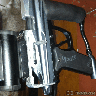

I always wanted to have a pellet shooting airgun. But due the
The high cost to obtain it ,I decided to convert my old Azodin paintball marker to a .22 cal pellet gun by replacing the .68 cal barrel with a Crosman 2240 barrel.

I actually got the idea for the project from a guy AK Custom on youtube on how turn a semi auto marker to a bolt action pellet rifle. I disabled the semi auto function in the marker by replacing the valve stem with pump action valve stem. The semi auto stem a section of the rod cut away to allow some air to push the hammer back to engage the sear while the pump action one has no such feature. This mods ensures that all the air is used on pushing the pellet in the barrel.
I enlarged the original paintball loading hole using a hacksaw and files.

Image of the loading gate.
The completed build. The conversion actually works .Shots were surprisingly accurate. This was probably due to the rifled barrel. As for power and fps I am not very sure as I have no access to a chrono

I see something now, do you load through the cutout in the breech?
Syllog
Posts: 5
Joined: Tue Jan 27, 2015 3:58 pm
Mon Sep 18, 2017 5:44 am
Yes . Pellet is loaded directly into the barrel and pushed in further by the brass pin or probe I installed inside the bolt.
