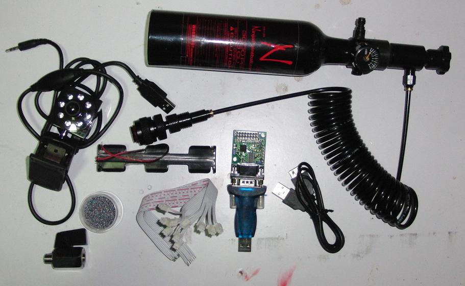

Well, the first bit of hardware is finally here :)
For work to begin on the turret though the postman still needs to get me the following:
Serial-USB adapter <--- edit: arrived
Elevation and traverse servos
Battery box & associated wiring <--- edit: arrived
Webcam
As to the gun itself:
Trigger servo
1/8" ball valve
Webcam
1mm BBs
I'm not sure if my local hobby store stocks 1mm I/D tubing for the barrel, if not I have some nice 1mm diameter piano wire that will make for a good casting. Looking at that wire made me realise how small the calibre is and how pathetic power will probably be at more than a couple of metres distance. This isn't a problem though, the program is really only good for a fixed range as it sees in 2D and therefore cannot make appropriate adjustments for windage and projectile drop anyway.

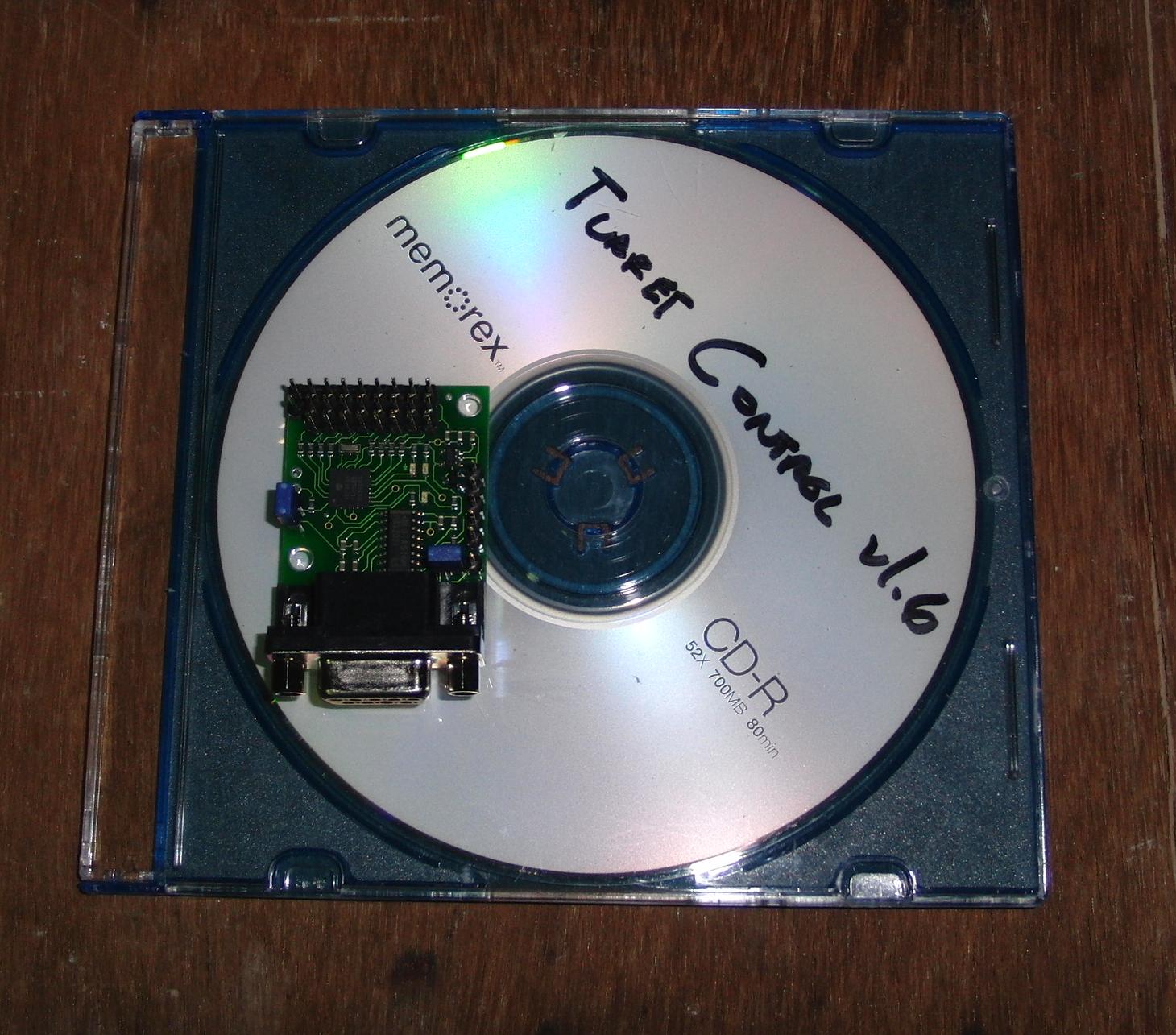

I think it could. On that board, it seems all there is is a RS232 interpreter (can be had for $2 or sampled) and a mux.

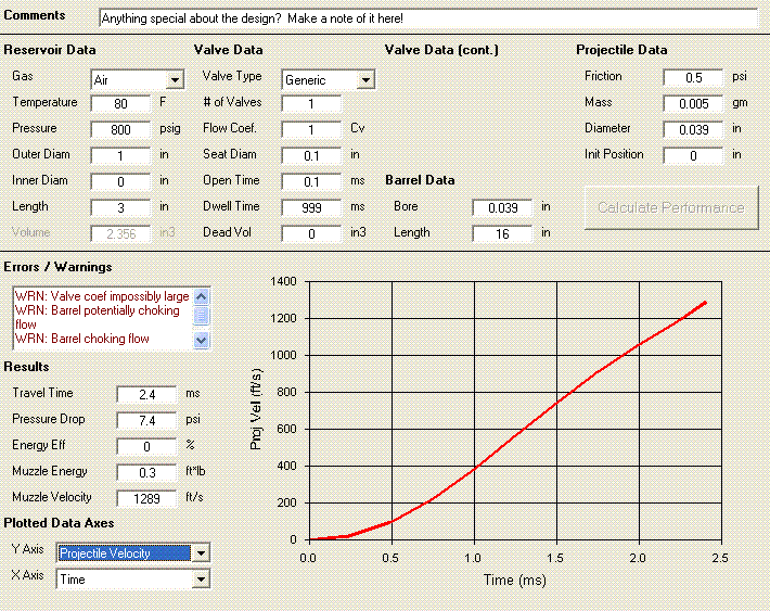

Update on the parts list, still waiting for those all important servos but otherwise most of the bits have arrived. Those 1mm BBs are *really* tiny, I'm curious to see how they will perform. I also found a better deal, 100 grams (that's over 20,000 BBs) for $10 posted.
Edit: turns out I did have some 1mm tubing after all, did some single shot testing with 2 feet of this made as a barrel insert for the V2 pengun at 800 psi. The little things will happily punch through both sides of a beer can a few inches away but only dent a second can, and will not penetrate the bottom of a can.
Not bad when you consider it has the same sort of muzzle energy as a 0.25 gram airsoft BB at 150 feet per second, and these are just single shots, with a BBMG firing 50 shots per second it will be a different story...
GGDT predicts supersonic speeds, a mach 1 sandblaster then :D
