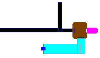

Here's a very quick diagram of the gun.
The dark blue thing is a schrader, where the inflator will be connected. The light blue chamber is where the pressure is built up. The brown square is the QEV and the pink thing is the pop-off valve. The black rectangle is the barrel.
How does that look?[/img]

general idea is nice, thoug not sure how well your clip will work... what keeps the pressure from blowing the BBs out of it, or just not letting them down, and if they do come down, what keeps them all from emptying at once?

Woa, that clickie regulator is just what i need.... too bad they dont seem to sell it to particulars outside U.S.
The gun will be fed trough the magazine, equiped with a basic, non-inovative blow-forward bolt. I have'nt displayed it on the diagram because it was not useful for the question.
The pop-off valve i will use should pop-off at 115 PSI. Looking at the pressure chart, im afraid i might need a lower pop-off valve.
