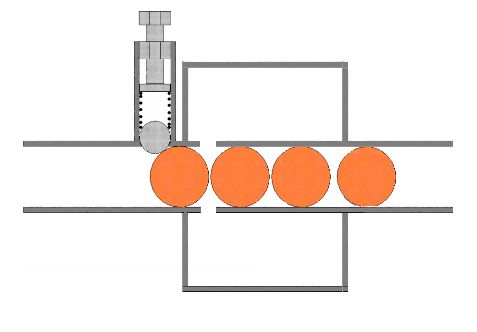

This what I was thinking, just before the detent I'll have a section of perforated barrel tube feeding the BBs held within a larger diameter tube as a "chamber", something like this:

jsr;
That looks feasible, just increase diameter like psycix stated.
A tapered shape before the chamber ports.
More ammo and better flow.
Thu Oct 08, 2009 7:56 am
I think I'll keep the main tubes at 4.5mm, capacity will be sufficient for my purposes and it will reduce the likelyhood of jams. Steel BBs are 4.4mm so there'll be adequate blow-by to fill the chamber. The chamber section can be a 6mm tube with perforations held within a small section of larger tubing. I'll start making it this evening, hopefully I'm on to a winner :)
