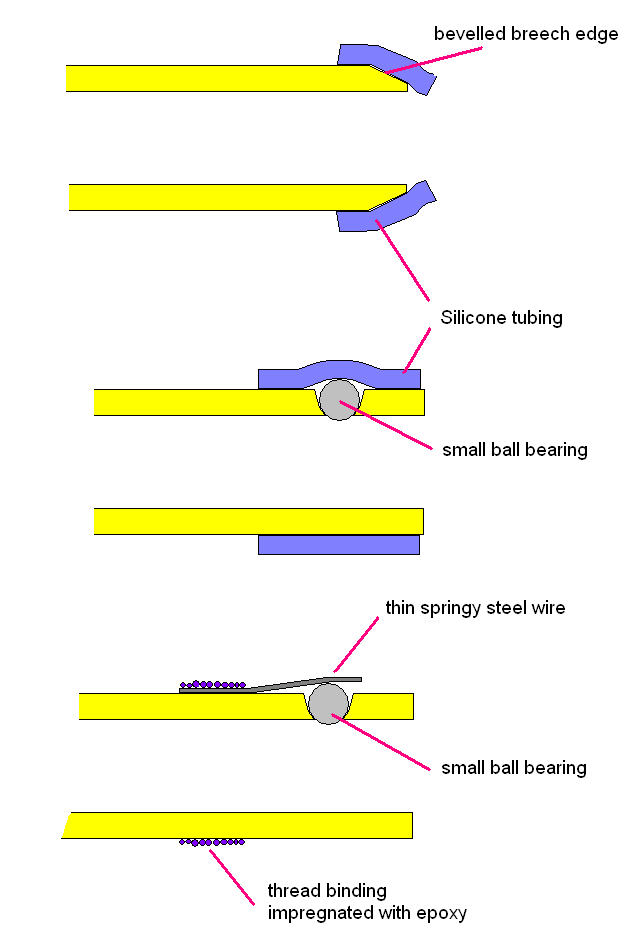

Could I make a detent from a bb with a spring behind it intersecting the barrel, I saw that other places, but how would I make one.
Wed Aug 31, 2011 10:41 am
here's some other ways of making a detent, silicone tubing is a good thing to have :) make sure the inner diameter is slightly smaller than your projectile diameter, for example 4mm ID tubing for 4.5mm BBs.
