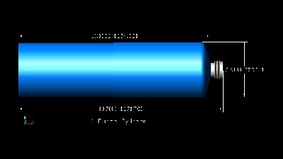

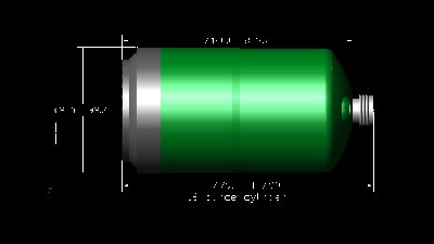

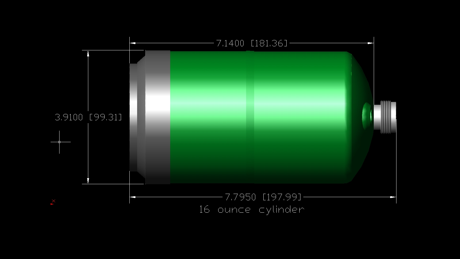

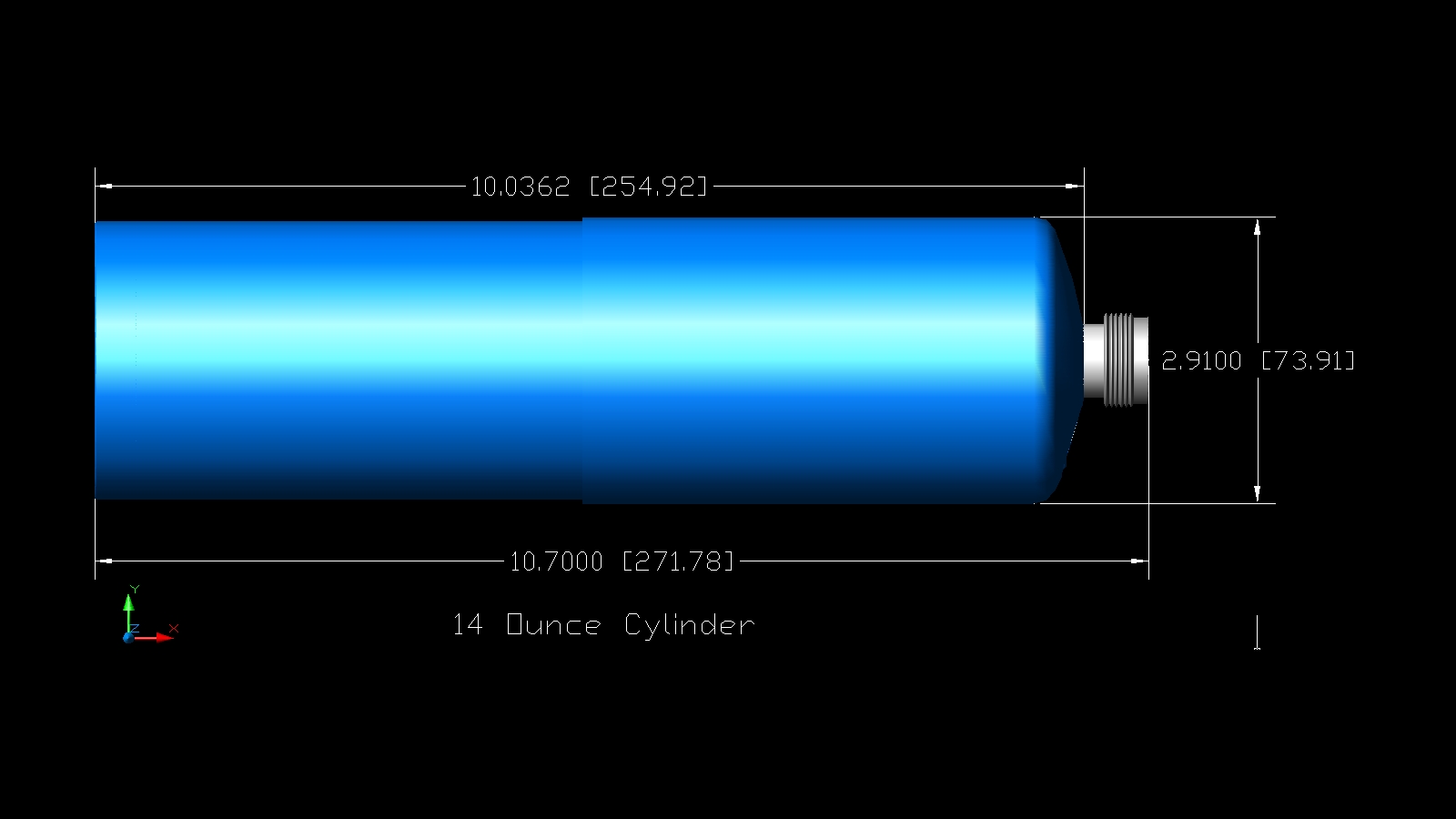

pack of 12 for 50$ isint bad. Any idea of the dimensions of it? its either gotta be in a backpack, or small enough to fit in the buttstock of the styre.

Here are dimensions for a typical 14 ounce cylinder.
Home Depot has them (BernzoMatic) for about $3 each.
edit: added 16 ounce cylinder
