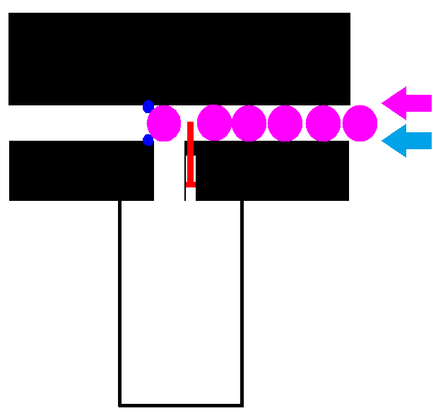

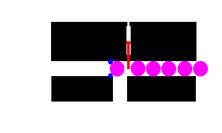

here is my draweeng:

here is my draweeng
I see it working with a spring behind the BBs and pulsed airflow, but otherwise...

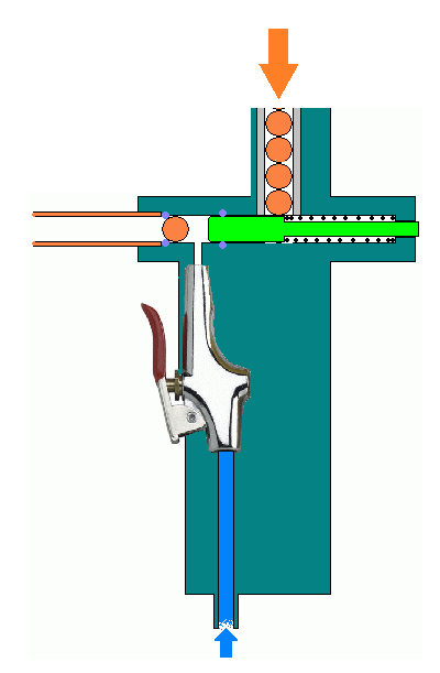

Maybe something like the attached, fed with a hopper?
lol it has an aircylinder so it's great (lol you do realize that's an air cylinder right ? I didn't include tubing in that diagram)
Plus the vertical port is there just to act as a chamber - it's fed air through the mag

POLAND_SPUD wrote:lol it has an aircylinder so it's great (lol you do realize that's an air cylinder right ? I didn't include tubing in that diagram)
Sat Dec 10, 2011 10:42 pm
yeah, exactly... it should work quite well as far reliability is concerned

I think thats actually actually a very feasible idea... I might have to try this one, i wish I could pump out concepts like you do :roll:
