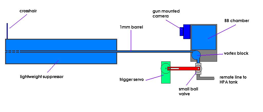

I've been thinking about the gun itself in the meantime, I want something that can engage small fast moving targets, this means a high rate of fire is essential to ensure good hit probability. For once, a vortex block BBMG is actually ideal
not too keen on filling the place with 0.177" BBs though, I was thinking of 3mm as I had used in my "micro" BBMG, but I figured I would go the whole hog and go for 1mm. Some of the benefits include:
- light weight (more than 70 times lighter per round than 0.177" BBs) which is a consideration when the chamber is turret mounted
- cheap, you can get 5000 for $14.99 from eBay sold as nail art decoration (so the more camp can get them in a variety of colours
) so they are inexpensive enough to be disposable
- with HPA they will reach high velocity and be devastating at close range, but it will taper off relatively quickly, like birdshot from a shotgun, limiting effective range and rendering them harmless if they should be fired into the air.
- A 1mm barrel has 20 times less flow than a 0.177" barrel, greatly limiting flow and therefore is much more economical with air.
Given the above consideration, a slightly open ball valve (say around 1/4") will provide more than enough flow to exceed the barrel flow, so I think the simples option is to have such a valve operated by the trigger servo, it doesn't have to move much so the power should be there. I've also ordered a remote line so the HPA tank can be separate from the turret.
I've ordered another cheapo webcam that will be permanently mounted to the gun, this way I can mount a simple crosshair that will greatly simplify calibrating the system. The idea is that I match target location on the crosshair to impact point at the average target range, say 10 metres, and after that I don't have to match any calibration points with actual shots, just line them up with the crosshairs.

- sentrygun1mmconcept.JPG (35.91 KiB) Viewed 3532 times

The silencer looks like it will cause the barrel to bow a little. Perhaps omit it completely, recoil won't be too great and who cares about noise when you have an automated machine gun?
The diagram I posted is a basic layout, in practice it will look different. still having second thoughts about the valve, ideally a solenoid would be the neatest solution but I can't find one that can handle high pressures at a reasonably cheap price. I think I'll have a go at rebuilding this unit - 3mm porting will give 9 times the flow of a 1mm barrel so it should suffice for instant high pressure in the chamber - before making any further investments.
As I'm in an urban environment I want it to be as stealthy as possible, with such a small bore it's unlikely to make much noise anyway but a simple silencer made from say a section of PET bottle would not add much weight and it would certainly cut down on the muzzle blast.

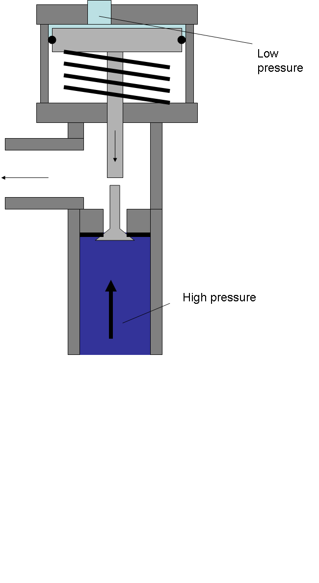

building your own solenoid valve is a possibility but I'm having trouble imagining a cheap and simple design
what about a high pressure poppet actuated by a low pressure piston, the electric valve for low pressure are more affordable
- hpvalvelppilot.PNG (25.84 KiB) Viewed 3395 times
That would work but you're introducing an extra power supply for the solenoid valve as well as a low pressure air source, not all the added complexity might as well use a servo actuated ball valve.

@iknowmy3tables
that's probably not practical here as there are ready made solenoid valves that can handle high pressures. But I like the way you think
