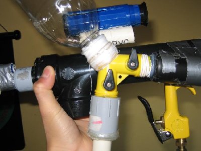

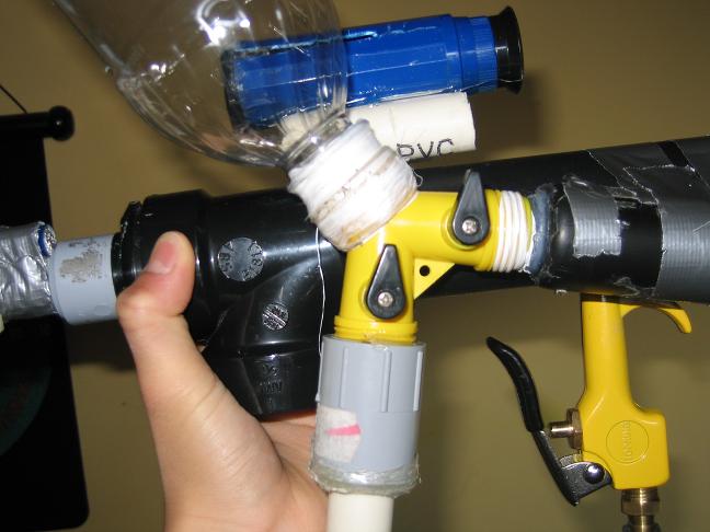

Pump System
The gun can be easily pumped up while running so it can be ready to blast the next person around a corner. The Pump is a regular sports pump attached to a 2-way hose splitter with ball valves to regulate flow. After I pump up the pop bottle, the valve that leads to the pump is closed. (yes there are some small leaks). then the valve to the blowgun is opened and it is ready to fire. I epoxied the hose to the 1/2 inch pipe and attached the pipe to the 1/2 inch threaded fitting.

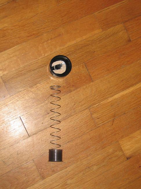

The Gun Itself
The gun i made a while ago but since I dont have a compressor :( I I had to use a shitty 2 inch pipe as an air reservoir which took a while to pump up. So I kind of abandoned the gun for a while until this Idea took shape.

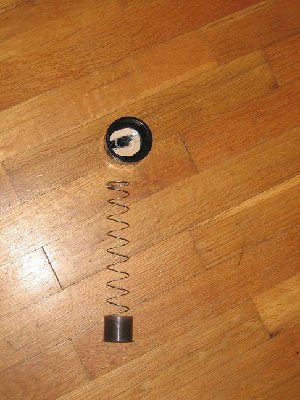

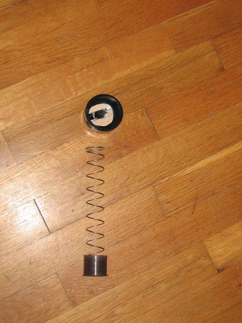

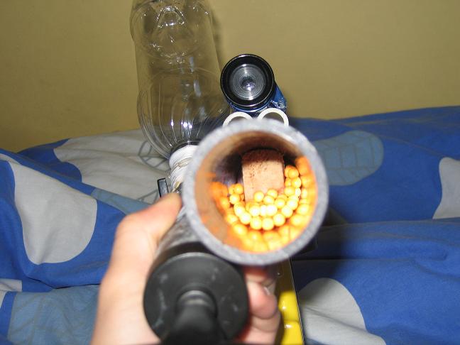

There is a half hole vortex block made of wood in a 1.5 inch pipe. the plunger is a spring from a broken sprinkler (I Found) at my school :twisted:
Overall, the gun is pretty well made except the duct tape parts which I plan to glue on later and the un-pressure rated hose, which is probably ok to do the job because of such low pressures that I pump it up to.
the 2 way valve
the 2 way valve
plunger and endcap
plunger and endcap
vortex block and bbs

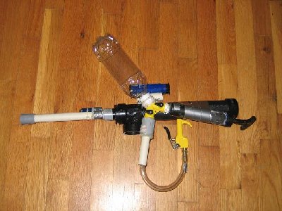

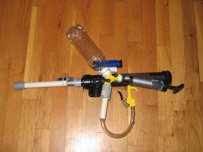

The Gun
The Gun

Looks great, how's the rate of fire?
Also, how well do those ball valves stay sealed?

The shootings pretty good, considering that it is charged by a hand pump. The effective range is about 30 meters, which is the bbs accurately hitting a tree at that range. The rof is about 50 rps, but this is with a low air supply.
potatoflinger wrote:Also, how well do those ball valves stay sealed?
The ball valves are consistantly solid, I have to worry more about the bottle busting than the valves, although that hasn't happened yet :?

Nice airgun. It just looks as if its ganna fallapart anysecond though. I would intergrate some wooden parts to make it more sturdy.

ant wrote:Nice airgun. It just looks as if its ganna fallapart anysecond though. I would intergrate some wooden parts to make it more sturdy.
Ahaha totally! I just had the "ghetto urge" at that moment and duct taped everything together :twisted: Ya but seriously i probably will make it un ghetto soon with some glue and wood
