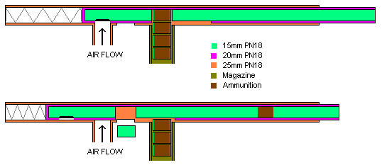

my bolt action, combination of blow forward and blowback

its not so much a blowforward bolt as it is a blowforward and blowback bolt combined into good old .......borwrack goodness...lol..... SmileSmile Very Happy
the only problem i might see is figuring out how to get it to fire so the bolt gets pushed back before the valve triggers again.. I figured out though that i can adjust that by increasing and decreasing chamber volume and pressure.

please don't start ripping on it right away about how bad I will fail. I'll just try even harder to prove you wrong... give it a chance. k you don't need a spring, because it operates similar to an AK47- the air behind the projectile goes up that black tube and pushes the bolt back again in place. Then it fires, the projectile goes down the barrel, air goes up the black tube, pushes the bolt back, and the whole process begins again.

So what kinda valve are you using here? A slide over valve>> or a poppet one? I dont c the benefit of this one over the blowforward poppet breech. You will always experience problems with recocking when the pressure of the airsource drops. The best I idea I have seen so far is the one of jack> a piston with a poppet at the back. The problem is that it needs lots of parts. But yeah go for it; it will prob look pretty cool. But keep in mind> a gun like an ak always has the same pressure as each round contains roughly the same amount of energy.

'll post a new topic for it. the benefit of this would be no spring would have to be used to recock it, thus allowing a faster recock time than a spring would be able to do. Even if you got a super strong spring, your air flow would have to fight that spring just to push the bolt forward. WIth this design, there is no fighting, its unopposed pushing for firing and recocking. and yea pressure drops might be a problem.... but not necessarily because as the pressure to recock goes down, the pressure to fire will also go down. TO combat this, I'm going to use some super thin o-rings so there is not as much resistance. I might lose a little air, but when i run this at the 300 or up PSI i plan on for my marble gun, it doesn't really matter now does it.
I'll have to test it.

I still don't get it :?

I kinda get the picture, but, why use pneumatic actuation in both ways (blow-back and -forward)
If you just use a spring then you can simplify it.

you know gas operated loading system arn't very practical in low presur pneumatic loading system, gas operation in guns is practical because many powerful rifle rounds are too strong for direct blowback and open too fast so gas operation is used to slow the bolt opening, the presure in a gun barel when fireing is thousands of times more powerful than that of any homemadeairgun
there is definatly not enough power from the tapped gas to counter the air source, thats like trying to use a gas operated system to put the bullet back in it's shell, and their is no mode for the presure to acumulate exept for the friction in that green seal, which that friction must be countered by the force from a small bit of tapped gas from the shot which only had just enough pressure built up to to push the bolt off the green seal

its not countering the air source, because the air source won't be operating when the bolt is being pushed back, the chamber will be filling when it is getting blown back. plus it won't be low pressure, it will be operating at around 300 PSI or more.
The reason I designed this is that there are problems with using springs.
1) The air has to fight the spring to blow the bolt forward, making it slower and you have to use more air than my design
2) The spring takes longer to push the bolt back than air will.
3) WHile it might seem its fighting the air that's blowing the bolt forward, its really not. Instead, the bolt gets pushed forward, the air behind the marble pushes the bolt back WHILE THE CHAMBER IS FILLING UP AGAIN. maybe i should have mentioned this will be used with a QEV popoff combination so the chamber will be filled for a short amount of time... woops sorry if i didnt mention it. so the bolt will be pushed forward by air already pressurized in the chamber... I'm working on a prototype right now..

Iknowmy3tables is right, 300psi IS low pressure compared to the 58,700psi of the .30-06.
The valve won’t be closed by the time the gas hits the gas tube, your going to need to have more surface area on the gas piston than the back of the blow-forward bolt. Other wise the gas system won’t be able to overcome the blow-forward bolt.
300psi gives it a chance, remember: “it’s all about the cubic inches.”
I plan on using gas operation, only I’m goin’ with John Browning’s M1895 (potato digger) type gas system as it allows for more leverage.
It’s a good design though.

k well maybe i'll have to revise it. i'll have to look at what you are talking about
