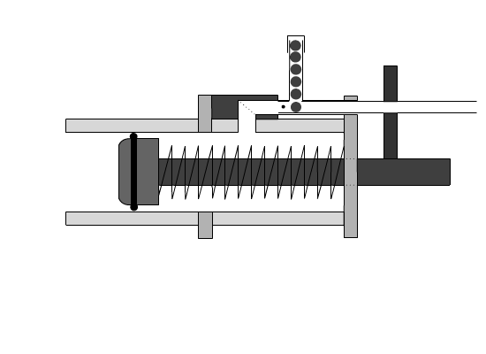

Tadaaaaaa, this is the simple diagram havent got time for the detailed one.

PS: the drawing is not to scale

Tom wrote:Tadaaaaaa, this is the simple diagram havent got time for the detailed one.
Tom
Hum... s'cuse the silly question, but i dont see the bolt that block air from going into the magazine tube, where is it on the diagram?

Sun Jul 13, 2008 4:19 am
When i trigger the valve, the air pushes the bolt forward. when it has reached the hole that is connected to the breech the air will flow into the breech, because there is no more force on the bolt from the air. The spring pushes the bolt back and tadaa ready to cycle again.

Sun Jul 13, 2008 10:03 am
Tom wrote:When i trigger the valve, the air pushes the bolt forward. when it has reached the hole that is connected to the breech the air will flow into the breech, because there is no more force on the bolt from the air. The spring pushes the bolt back and tadaa ready to cycle again.
G's from the Dutch, Tom
Yup, makes sense. I was just taking as granted that there is a bolt that blocks the magazine when air flows into the barrel, just like in many blow forward design. But i guess you must just let the air get into the magazine and not care because it's sealed by a cap.
