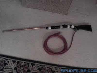

Here's the gun, It uses air from my compressor.
<img src="http://www.spudfiles.com/official_pics/2.jpg">

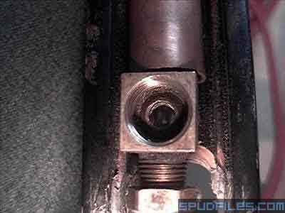

Here is all the main parts of the loading mechanism, which really consists of a special tee fitting that the barrel passes through, which is drilled through from the other top female part of it, for dropping bb's into it.
<img src="http://www.spudfiles.com/official_pics/3.jpg">
That's the hole that the bb's are dropped into.

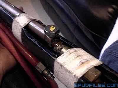

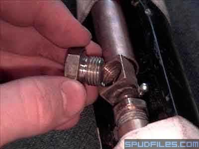

That's the screw that plugs the breech when firing.
<img src="http://www.spudfiles.com/official_pics/5.jpg">

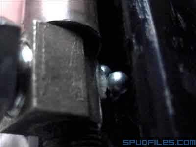

Here is the small but powerful magnet that holds the bb in place when preparing to shoot. It also
conveniently sucks the bb down when loading, no shaking it around to get the bb to drop through.
<img src="http://www.spudfiles.com/official_pics/6.jpg">

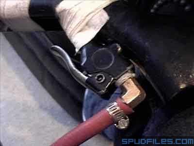

Here's the trigger, which has continuous feed from my compressor.
<img src="http://www.spudfiles.com/official_pics/7.jpg">
The things pretty damn accurate, just look along the barrel and pull the trigger sharply.
Its very accurate for a gun made from scratch that does not even have sights on it. The copper tubing is just for looks, the barrel is sleeved inside of it. notice the redneck securing fashion I used for it -tape. All in all a damn nice and functional gun. gonna go shoot some starlings with it, at least I'll scare them with it.
