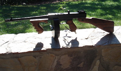

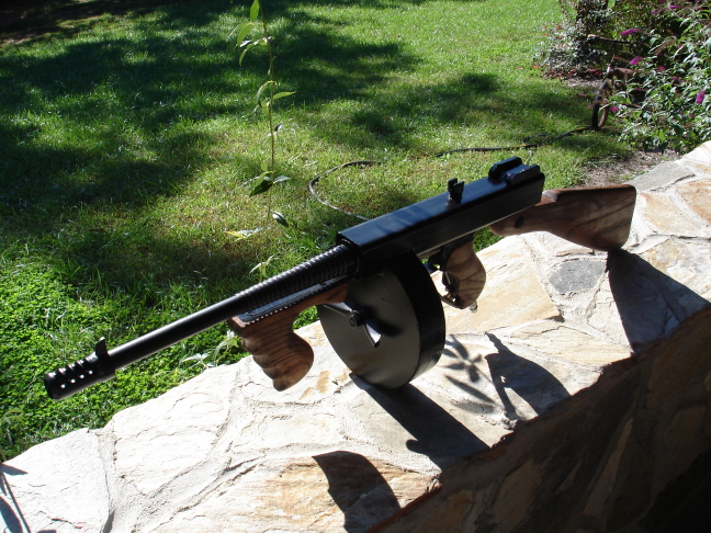

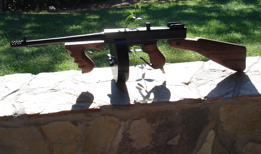

Ive always loved these guns and a few weekends ago O Brother Where Art Thou? was on so i decide to start on a completely homemade airsoft vortex Chicago style Thompson sub machine gun
specs:
1 inch chamber running along the total length of the square tubing
steel vortex block
brass 6mm barrel
the grips and but stock is made of oak a piece of brake line was bent up to travel from the blowgun (routed into the grip) to the vortex block
the whole thing took around a week to make and being my first vortex gun it turned out pretty well
ill try to get a vid up soon of me killing some cans

Great job. What was the receiver and drum made of?
Does it have a spring to push the bbs? Looks like the real thing.

the drum is mad out of 2 plywood circles with a heavy coat of primer and the receiver is the square tubing

It looks awesome, but your barrel is on a angle with the grip which looks a little weird.
