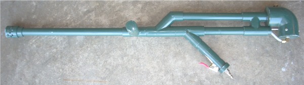

Check out the bbmg starfer forum for all kinds of imformation on different types of bbmgs. You can see my MP5 set up on the ready to assemble picture. I try to keep under a 14 in. barrel. This will empty 2000 bbs in less then a minute. I'm running 125 lbs. off my compressor for it.

3 foot length of 1/4" OD (0.188" ID) stainless steel tubing for the barrel
firing 0.177" copper/steel BBs (0.33g)
Vortex type chamber
120 PSIG compressor output
Chronometer results:
ROF 50 +/-10 RPS (~3000 RPM)
Muzzle Velocity 340 +/-40 FPS
KE 1.6 J (1.2 foot-pounds) per BB
(the velocity and ROF are not consistent BB to BB or as the compressor's resevoir pressure drops.)
