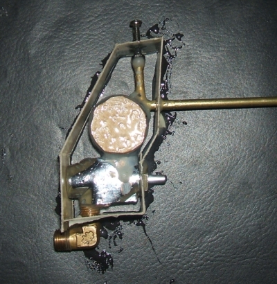

I would also like to try out a burst fire pen gun, something conceptually similar to this design but co-axial so the chamber has to be wider than 6mm to accomodate the BB reservoir, marker gun perhaps.
As always, watch this space :)
edit: here's how it's looking in my head:
