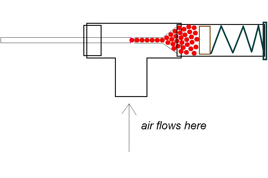

I've been thinking of something like this (that's just a very rough sketch) ->

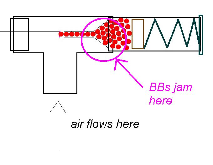

You're going to have to put a bit more thought into it, if it worked this way then no one would bother with vortex blocks...
The magazine tube would have to be less than twice the diameter of one BB, otherwise you need some mechanical means (say a motor driven paddle) of agitating the BBs for reliable feeding.
That's the basic idea, you don't need to worry about large magazines because you can destroy the target with less rounds.
Say you're using a 50cm barrel, you could have a 50 round 0.5" wide tube magazine + spring fit comfortably. Also, 10 round per second is still a bit high, I would be happy with 2-5 (DAKKA DAKKA DAKKA, remember
That's for 9mm though, a 50cm barrel for 6mm ammunition gives you at least 75 rounds easily in a parallel magazine
so your talking about 9mm right ?? that would pack more punch per one bullet but you are limited to ball-bearings only
20 rounds hmmm that's only 2 seconds at 10RPS
I wants 10 second bursts... lol

actually I was thinking that in each 'cycle' the plunger (if it was tight fit) would move slightly forth and back thereby agitating BBsagitating the BBs for reliable feeding
but yeah I have to agree that your idea is probably simpler
