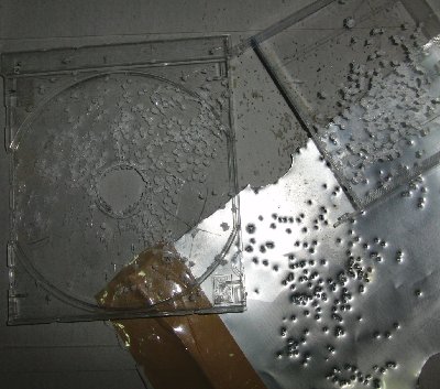

Nothing remarkable about the design, it's a conventional vortex block fed with 800 psi from a HPA remote line, but the calibre is certainly the smallest ever, at least on this forum. As you can see from the video below most shots will go clean through sheet acrylic or the aluminium skin of a beer can, that might not sound like impressive performance but remember that it takes 70 of these tiny projectiles to make up the weight of one 0.177" BB ;)

Oh also is tha aluminum foil that you are shooting at in the first part of the video?

is that aluminum foil that you are shooting at in the first part of the video?
It's an opened up beer can, see below - I couldnt shoot the actual beercan because it would have made my location pretty obvious :D

Here's a nice macro view of the damage, as you can see some BBs are still embedded in the various media:
