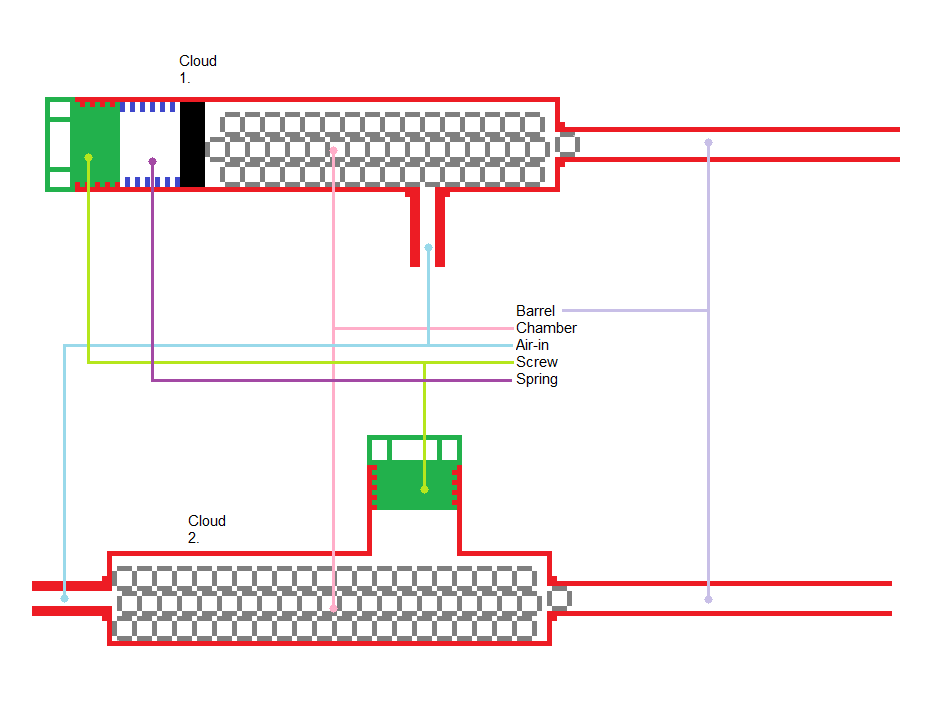

Hi there, I have looked around here a lot and i found that a "cloud" is easy to make and is very low maintenance and can be cheap.
these properties suit me well because i'm planning to build a few for me and my friends.
I will use copper piping and fittings for the chamber, hopup and the outside of the barrel, the inside of the barrel will be aluminium.
barrel id= 6mm
chamber id= 20mm
I will use a blowgun as valve.
I'm not sure about the air supply, i want something like a cola bottle, but better and still cheap.
Id like some input on this thanks.
it will not be regulated and it will be pumped up by a sports-pump.
I realize that it wont be able to shoot for long and it will not shoot consistent.
All this will be made into one (no backpack).
now i have a few questions (look at pics).
1. what configuration would suit me better, cloud 1 or 2?
2. Will the spring-plunger in (cloud1) be helpful or cause jams?
I will not make a vortex due to small id chamber, production time.

I don't think people use spring plungers on clouds, the bb's need room to actually fly around and make the "cloud". I say design one without the plunger, but why copper anyway? If it is for color, use PVC and paint it. Besides, you said you were going to use a pop bottle for a tank (which would be horrible) so you can't be using more than 100 psi, which makes copper absolutely pointless. Also I would say use a bigger chamber, 20mm sounds rather small, use like 1.5" or 40mm I think.
I'm preferring copper for the connections, availability and durability, Iamb not keen with seriously hurting my friends due to pvc shatter
Iamb not going to use a cola bottle this is just to let you know what dimensions i'm looking for. it has to have a volume of about 1L and take about 80 psi or more
yes the chamber is small but with copper its the largest that is available to me.
ok so cloud 1 without the plunger, thanks.
